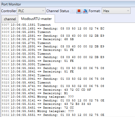

                Here is the output of the serial port:
                Since the solution works fine during multiple days without any error on the serial interface, I do not think there is an issue on the RS485 bus. Yes, I am using am appropriate shielded cable with terminations on both ends.

                            Data captured after communication stops working:
                            09:02:36.2939 => Sending: 02 03 50 12 00 02 75 3D
                            09:02:36.3139 <= Receiving: CB EC EB
                            09:02:36.3139 Timeout
                            09:02:36.3239 => Sending: 02 03 50 12 00 02 75 3D
                            09:02:36.3439 <= Receiving: CB EC EB
                            09:02:36.3439 Timeout
                            09:02:36.3639 => Sending: 02 03 60 00 00 02 DA 38
                            09:02:36.3839 <= Receiving: EC EB
                            09:02:36.3839 Timeout
                            09:02:36.3939 => Sending: 02 03 60 00 00 02 DA 38
                            09:02:36.4139 <= Receiving: 6D D5
                            09:02:36.4139 Timeout
                            09:02:36.4239 => Sending: 02 03 60 00 00 02 DA 38
                            09:02:36.4539 <= Receiving: 6D D5
                            09:02:36.4539 Timeout
                            09:02:36.4739 => Sending: 03 03 50 12 00 02 74 EC
                            09:02:36.4939 <= Receiving: 6D D5
                            09:02:36.4939 Timeout
                            09:02:36.5039 => Sending: 03 03 50 12 00 02 74 EC
                            09:02:36.5359 <= Receiving: 68 5B
                            09:02:36.5359 Timeout
                            09:02:36.5459 => Sending: 03 03 50 12 00 02 74 EC
                            09:02:36.5659 <= Receiving: 6F 68 5B
                            09:02:36.5659 Timeout
                            09:02:36.5859 => Sending: 03 03 60 00 00 02 DB E9
                            09:02:36.6059 <= Receiving: 68 5B
                            09:02:36.6059 Timeout
                            09:02:36.6159 => Sending: 03 03 60 00 00 02 DB E9
                            09:02:36.6459 <= Receiving: 3D F3 8F
                            09:02:36.6459 Timeout
                            09:02:36.6559 => Sending: 03 03 60 00 00 02 DB E9
                            09:02:36.6759 <= Receiving: F3 8F
                            09:02:36.6759 Timeout
                            09:02:36.7009 => Sending: 01 03 50 02 00 06 75 08
                            09:02:36.7209 <= Receiving: F3 8F
                            09:02:36.7209 Timeout
                            09:02:36.7309 => Sending: 01 03 50 02 00 06 75 08
                            09:02:36.7599 <= Receiving: 43
                            09:02:36.7599 Timeout
                            09:02:36.7699 => Sending: 01 03 50 02 00 06 75 08
                            09:02:36.8399 Timeout
                            09:02:36.8599 => Sending: 01 03 50 12 00 02 75 0E
                            09:02:36.8599 <= Receiving: 43 73 00 00 43
                            09:02:36.8599 <= Receiving: 72 99 9A A3
                            09:02:36.8599 Wrong telegram: ???
                            09:02:36.8699 => Sending: 01 03 50 12 00 02 75 0E
                            09:02:36.9399 Timeout
                            09:02:36.9499 => Sending: 01 03 50 12 00 02 75 0E
                            09:02:36.9699 <= Receiving: 62 23
                            09:02:36.9699 Timeout
                            09:02:36.9899 => Sending: 01 03 60 0C 00 02 1A 08
                            09:02:37.0099 <= Receiving: 62 23
                            09:02:37.0099 Timeout
                            09:02:37.0199 => Sending: 01 03 60 0C 00 02 1A 08
                            09:02:37.0519 <= Receiving: 9F
                            09:02:37.0519 Timeout
                            09:02:37.0619 => Sending: 01 03 60 0C 00 02 1A 08
                            09:02:37.1319 Timeout
                            09:02:37.1519 => Sending: 01 03 60 18 00 02 5A 0C
                            09:02:37.1719 <= Receiving: 00 5C
                            09:02:37.1719 Timeout
                            09:02:37.1819 => Sending: 01 03 60 18 00 02 5A 0C
                            09:02:37.2129 <= Receiving: 69 26
                            09:02:37.2129 Timeout
                            09:02:37.2229 => Sending: 01 03 60 18 00 02 5A 0C
                            09:02:37.2429 <= Receiving: 69 26
                            09:02:37.2429 Timeout
                            09:02:37.2629 => Sending: 02 03 50 12 00 02 75 3D
                            09:02:37.2829 <= Receiving: 52 69 26
                            09:02:37.2829 Timeout
                            09:02:37.2929 => Sending: 02 03 50 12 00 02 75 3D
                            09:02:37.3129 <= Receiving: EA 1D
                            09:02:37.3129 Timeout
                            09:02:37.3229 => Sending: 02 03 50 12 00 02 75 3D
                            09:02:37.3429 <= Receiving: EA 1D
                            09:02:37.3429 Timeout
                            09:02:37.3629 => Sending: 02 03 60 00 00 02 DA 38
                            09:02:37.3839 <= Receiving: EA 1D
                            09:02:37.3839 Timeout
                            09:02:37.3939 => Sending: 02 03 60 00 00 02 DA 38
                            09:02:37.4139 <= Receiving: 6D D5
                            09:02:37.4139 Timeout
                            09:02:37.4239 => Sending: 02 03 60 00 00 02 DA 38
                            09:02:37.4439 <= Receiving: 6D D5
                            09:02:37.4439 Timeout
                            09:02:37.4639 => Sending: 03 03 50 12 00 02 74 EC
                            09:02:37.4849 <= Receiving: 6D D5
                            09:02:37.4849 Timeout
                            09:02:37.4949 => Sending: 03 03 50 12 00 02 74 EC
                            09:02:37.5159 <= Receiving: 68 5B
                            09:02:37.5159 Timeout
                            09:02:37.5259 => Sending: 03 03 50 12 00 02 74 EC
                            09:02:37.5459 <= Receiving: 68 5B
                            09:02:37.5459 Timeout
                            09:02:37.5659 => Sending: 03 03 60 00 00 02 DB E9
                            09:02:37.5859 <= Receiving: 68 5B
                            09:02:37.5859 Timeout
                            09:02:37.5959 => Sending: 03 03 60 00 00 02 DB E9
                            09:02:37.6279 <= Receiving: F3 8F
                            09:02:37.6279 Timeout
                            09:02:37.6628 => Sending: 03 03 60 00 00 02 DB E9
                            09:02:37.6828 <= Receiving: F3 8F
                            09:02:37.6828 Timeout
                            09:02:37.7088 => Sending: 01 03 50 02 00 06 75 08
                            09:02:37.7288 <= Receiving: F3 8F
                            09:02:37.7288 Timeout
                            09:02:37.7388 => Sending: 01 03 50 02 00 06 75 08
                            09:02:37.7708 <= Receiving: 43 73
                            09:02:37.7708 Timeout
                            09:02:37.7808 => Sending: 01 03 50 02 00 06 75 08
                            09:02:37.8508 Timeout
                            09:02:37.8708 => Sending: 01 03 50 12 00 02 75 0E
                            09:02:37.8708 <= Receiving: CD 43 73 00 00
                            09:02:37.8708 <= Receiving: 43 72 99 9A
                            09:02:37.8708 Wrong telegram: ???
                            09:02:37.8808 => Sending: 01 03 50 12 00 02 75 0E
                            09:02:37.9508 Timeout
                            09:02:37.9608 => Sending: 01 03 50 12 00 02 75 0E
                            09:02:37.9808 <= Receiving: 62 23
                            09:02:37.9808 Timeout
                            09:02:38.0008 => Sending: 01 03 60 0C 00 02 1A 08
                            09:02:38.0218 <= Receiving: 62 23
                            09:02:38.0218 Timeout
                            09:02:38.0318 => Sending: 01 03 60 0C 00 02 1A 08
                            09:02:38.0628 <= Receiving: 00 5C
                            09:02:38.0628 Timeout
                            09:02:38.0728 => Sending: 01 03 60 0C 00 02 1A 08
                            09:02:38.0928 <= Receiving: 00 5C
                            09:02:38.0928 Timeout
                            09:02:38.1128 => Sending: 01 03 60 18 00 02 5A 0C
                            09:02:38.1338 <= Receiving: 00 5C
                            09:02:38.1338 Timeout
                            09:02:38.1438 => Sending: 01 03 60 18 00 02 5A 0C
                            09:02:38.1638 <= Receiving: 69 26
                            09:02:38.1638 Timeout
                            09:02:38.1738 => Sending: 01 03 60 18 00 02 5A 0C
                            09:02:38.1938 <= Receiving: 69 26
                            09:02:38.1938 Timeout
                            09:02:38.2138 => Sending: 02 03 50 12 00 02 75 3D
                            09:02:38.2338 <= Receiving: 69 26
                            09:02:38.2338 Timeout
                            09:02:38.2438 => Sending: 02 03 50 12 00 02 75 3D
                            09:02:38.2638 <= Receiving: EA 1D
                            09:02:38.2638 Timeout
                            09:02:38.2738 => Sending: 02 03 50 12 00 02 75 3D
                            09:02:38.2938 <= Receiving: EA 1D
                            09:02:38.2938 Timeout
                            09:02:38.3138 => Sending: 02 03 60 00 00 02 DA 38
                            09:02:38.3338 <= Receiving: EA 1D
                            09:02:38.3338 Timeout
                            09:02:38.3438 => Sending: 02 03 60 00 00 02 DA 38
                            09:02:38.3638 <= Receiving: 6D D5
                            09:02:38.3638 Timeout
                            09:02:38.3738 => Sending: 02 03 60 00 00 02 DA 38
                            09:02:38.4048 <= Receiving: 6D D5
                            09:02:38.4048 Timeout
                            09:02:38.4248 => Sending: 03 03 50 12 00 02 74 EC
                            09:02:38.4448 <= Receiving: 6D D5
                            09:02:38.4448 Timeout
                            09:02:38.4548 => Sending: 03 03 50 12 00 02 74 EC
                            09:02:38.4748 <= Receiving: 68 5B
                            09:02:38.4748 Timeout
                            09:02:38.4848 => Sending: 03 03 50 12 00 02 74 EC
                            09:02:38.5158 <= Receiving: 68 5B
                            09:02:38.5158 Timeout
                            09:02:38.5358 => Sending: 03 03 60 00 00 02 DB E9
                            09:02:38.5558 <= Receiving: 68 5B
                            09:02:38.5558 Timeout
                            09:02:38.5658 => Sending: 03 03 60 00 00 02 DB E9
                            09:02:38.5858 <= Receiving: F3 8F
                            09:02:38.5858 Timeout
                            09:02:38.5958 => Sending: 03 03 60 00 00 02 DB E9
                            09:02:38.6158 <= Receiving: F3 8F
                            09:02:38.6158 Timeout
                            09:02:38.6408 => Sending: 01 03 50 02 00 06 75 08
                            09:02:38.6608 <= Receiving: F3 8F
                            09:02:38.6608 Timeout
                            09:02:38.6708 => Sending: 01 03 50 02 00 06 75 08
                            09:02:38.7028 <= Receiving: CD
                            09:02:38.7028 Timeout
                            09:02:38.7128 => Sending: 01 03 50 02 00 06 75 08
                            09:02:38.7828 Timeout
                            09:02:38.8028 => Sending: 01 03 50 12 00 02 75 0E
                            09:02:38.8028 <= Receiving: 43 73 19 9A 43
                            09:02:38.8028 <= Receiving: 72 B3 33 26
                            09:02:38.8028 Wrong telegram: ???
                            09:02:38.8128 => Sending: 01 03 50 12 00 02 75 0E
                            09:02:38.8828 Timeout
                            09:02:38.8928 => Sending: 01 03 50 12 00 02 75 0E
                            Free space in internal port monitor buffer: 59.7 kB
                            09:02:38.9628 Timeout
                            09:02:38.9828 => Sending: 01 03 60 0C 00 02 1A 08
                            09:02:39.0028 <= Receiving: 1B EE
                            09:02:39.0028 Timeout
                            09:02:39.0128 => Sending: 01 03 60 0C 00 02 1A 08
                            09:02:39.0448 <= Receiving: 00 5C
                            09:02:39.0448 Timeout
                            09:02:39.0548 => Sending: 01 03 60 0C 00 02 1A 08
                            09:02:39.0748 <= Receiving: 00 5C
                            09:02:39.0748 Timeout
                            09:02:39.0948 => Sending: 01 03 60 18 00 02 5A 0C
                            09:02:39.1148 <= Receiving: 00 5C
                            09:02:39.1148 Timeout
                            09:02:39.1512 => Sending: 01 03 60 18 00 02 5A 0C
                            09:02:39.1712 <= Receiving: 69 26
                            09:02:39.1712 Timeout
                            09:02:39.1812 => Sending: 01 03 60 18 00 02 5A 0C
                            09:02:39.2012 <= Receiving: 69 26
                            09:02:39.2012 Timeout
                            09:02:39.2212 => Sending: 02 03 50 12 00 02 75 3D
                            09:02:39.2412 <= Receiving: 69 26
                            09:02:39.2412 Timeout
                            09:02:39.2512 => Sending: 02 03 50 12 00 02 75 3D
                            09:02:39.2712 <= Receiving: EA 1D
                            09:02:39.2712 Timeout
                            09:02:39.2812 => Sending: 02 03 50 12 00 02 75 3D
                            09:02:39.3012 <= Receiving: EA 1D
                            09:02:39.3012 Timeout
                            09:02:39.3212 => Sending: 02 03 60 00 00 02 DA 38
                            09:02:39.3422 <= Receiving: EA 1D
                            09:02:39.3422 Timeout
                            09:02:39.3522 => Sending: 02 03 60 00 00 02 DA 38
                            09:02:39.3722 <= Receiving: 9A 6D D5
                            09:02:39.3722 Timeout
                            09:02:39.3822 => Sending: 02 03 60 00 00 02 DA 38
                            09:02:39.4022 <= Receiving: 6D D5
                            09:02:39.4022 Timeout
                            09:02:39.4222 => Sending: 03 03 50 12 00 02 74 EC
                            09:02:39.4422 <= Receiving: 6D D5
                            09:02:39.4422 Timeout
                            09:02:39.4522 => Sending: 03 03 50 12 00 02 74 EC
                            09:02:39.4722 <= Receiving: 68 5B
                            09:02:39.4722 Timeout
                            09:02:39.4822 => Sending: 03 03 50 12 00 02 74 EC
                            09:02:39.5022 <= Receiving: 68 5B
                            09:02:39.5022 Timeout
                            09:02:39.5222 => Sending: 03 03 60 00 00 02 DB E9
                            09:02:39.5422 <= Receiving: 68 5B
                            09:02:39.5422 Timeout
                            09:02:39.5522 => Sending: 03 03 60 00 00 02 DB E9
                            09:02:39.5722 <= Receiving: F3 8F
                            09:02:39.5722 Timeout
                            09:02:39.5822 => Sending: 03 03 60 00 00 02 DB E9
                            09:02:39.6032 <= Receiving: F3 8F
                            09:02:39.6032 Timeout
                            09:02:39.6282 => Sending: 01 03 50 02 00 06 75 08
                            09:02:39.6482 <= Receiving: F3 8F
                            09:02:39.6482 Timeout
                            09:02:39.6582 => Sending: 01 03 50 02 00 06 75 08
                            09:02:39.6892 <= Receiving: CD
                            09:02:39.6892 Timeout
                            09:02:39.6992 => Sending: 01 03 50 02 00 06 75 08
                            09:02:39.7692 Timeout
                            09:02:39.7892 => Sending: 01 03 50 12 00 02 75 0E
                            09:02:39.7892 <= Receiving: 43 73 00 00 43
                            09:02:39.7892 <= Receiving: 72 99 9A A3
                            09:02:39.7892 Wrong telegram: ???
                            09:02:39.7992 => Sending: 01 03 50 12 00 02 75 0E
                            09:02:39.8692 Timeout
                            09:02:39.8792 => Sending: 01 03 50 12 00 02 75 0E
                            09:02:39.9492 Timeout
                            09:02:39.9692 => Sending: 01 03 60 0C 00 02 1A 08
                            09:02:39.9892 <= Receiving: 5C 1B EE
                            09:02:39.9892 Timeout
                            09:02:39.9992 => Sending: 01 03 60 0C 00 02 1A 08
                            09:02:40.0292 <= Receiving: 3D
                            09:02:40.0292 Timeout
                            09:02:40.0392 => Sending: 01 03 60 0C 00 02 1A 08
                            09:02:40.1092 Timeout
                            09:02:40.1292 => Sending: 01 03 60 18 00 02 5A 0C
                            09:02:40.1492 <= Receiving: 00 5C
                            09:02:40.1492 Timeout
                            09:02:40.1592 => Sending: 01 03 60 18 00 02 5A 0C
                            09:02:40.1792 <= Receiving: 69 26
                            09:02:40.1792 Timeout
                            09:02:40.1892 => Sending: 01 03 60 18 00 02 5A 0C
                            09:02:40.2212 <= Receiving: 69 26
                            09:02:40.2212 Timeout
                            09:02:40.2412 => Sending: 02 03 50 12 00 02 75 3D
                            09:02:40.2612 <= Receiving: 52 69 26
                            09:02:40.2612 Timeout
                            09:02:40.2712 => Sending: 02 03 50 12 00 02 75 3D
                            09:02:40.2912 <= Receiving: DD 3E
                            09:02:40.2912 Timeout
                            09:02:40.3012 => Sending: 02 03 50 12 00 02 75 3D
                            09:02:40.3212 <= Receiving: DD 3E
                            09:02:40.3212 Timeout
                            09:02:40.3412 => Sending: 02 03 60 00 00 02 DA 38
                            09:02:40.3612 <= Receiving: DD 3E
                            09:02:40.3612 Timeout
                            09:02:40.3712 => Sending: 02 03 60 00 00 02 DA 38
                            09:02:40.4032 <= Receiving: 6D D5
                            09:02:40.4032 Timeout
                            09:02:40.4132 => Sending: 02 03 60 00 00 02 DA 38
                            09:02:40.4332 <= Receiving: 6D D5
                            09:02:40.4332 Timeout
                            09:02:40.4532 => Sending: 03 03 50 12 00 02 74 EC
                            09:02:40.4732 <= Receiving: 6D D5
                            09:02:40.4732 Timeout
                            09:02:40.4832 => Sending: 03 03 50 12 00 02 74 EC
                            09:02:40.5032 <= Receiving: 68 5B
                            09:02:40.5032 Timeout
                            09:02:40.5132 => Sending: 03 03 50 12 00 02 74 EC
                            09:02:40.5332 <= Receiving: 68 5B
                            09:02:40.5332 Timeout

                                        Hi @tomas_hora, issue occured again again with port 1.1 and new settings (Max telegram duration to 300ms + added a 5ms pause between telegrams.)
                                        A simple PLC reboot (from Debian OS) was enough to regain data acquisition from the 3 Inepro PRO380 meters.
                                        I do not understand why problem never occured when using port 1.3 of same PLC, nor with my previous M505.
                                        What is the difference between ports 1.1 and 1.3 ?
                                        If same hardware, could it be a hardware issue with port 1.1 on my M525?

                                        22:13:12.9993 <= Recv: CC D8
                                        22:13:12.9993 Timeout
                                        22:13:13.0093 => Send: 01 03 60 0C 00 02 1A 08
                                        22:13:13.0393 <= Recv: CC D8
                                        22:13:13.0393 Timeout
                                        22:13:13.0643 => Send: 01 03 60 18 00 02 5A 0C
                                        22:13:13.0943 <= Recv: CC D8
                                        22:13:13.0943 Timeout
                                        22:13:13.1043 => Send: 01 03 60 18 00 02 5A 0C
                                        22:13:13.1557 <= Recv: 72 00
                                        22:13:13.1557 Timeout
                                        22:13:13.1657 => Send: 01 03 60 18 00 02 5A 0C
                                        22:13:13.1957 <= Recv: 72 00
                                        22:13:13.1957 Timeout
                                        22:13:13.2207 => Send: 02 03 50 12 00 02 75 3D
                                        22:13:13.2507 <= Recv: 72 00
                                        22:13:13.2507 Timeout
                                        22:13:13.2607 => Send: 02 03 50 12 00 02 75 3D
                                        22:13:13.2907 <= Recv: 46 88
                                        22:13:13.2907 Timeout
                                        22:13:13.3007 => Send: 02 03 50 12 00 02 75 3D
                                        22:13:13.3307 <= Recv: 46 88
                                        22:13:13.3307 Timeout
                                        22:13:13.3557 => Send: 02 03 60 00 00 02 DA 38
                                        22:13:13.3857 <= Recv: 46 88
                                        22:13:13.3857 Timeout
                                        22:13:13.3957 => Send: 02 03 60 00 00 02 DA 38
                                        22:13:13.4257 <= Recv: 85 9B
                                        22:13:13.4257 Timeout
                                        22:13:13.4357 => Send: 02 03 60 00 00 02 DA 38
                                        22:13:13.4657 <= Recv: 85 9B
                                        22:13:13.4657 Timeout
                                        22:13:13.4907 => Send: 03 03 50 12 00 02 74 EC
                                        22:13:13.5207 <= Recv: 85 9B
                                        22:13:13.5207 Timeout
                                        22:13:13.5307 => Send: 03 03 50 12 00 02 74 EC
                                        22:13:13.5607 <= Recv: 68 5B
                                        22:13:13.5607 Timeout
                                        22:13:13.5707 => Send: 03 03 50 12 00 02 74 EC
                                        22:13:13.6007 <= Recv: 68 5B
                                        22:13:13.6007 Timeout
                                        22:13:13.6257 => Send: 03 03 60 00 00 02 DB E9
                                        22:13:13.6557 <= Recv: 68 5B
                                        22:13:13.6557 Timeout
                                        22:13:13.6657 => Send: 03 03 60 00 00 02 DB E9
                                        22:13:13.6957 <= Recv: CA CB
                                        22:13:13.6957 Timeout
                                        22:13:13.7057 => Send: 03 03 60 00 00 02 DB E9
                                        22:13:13.7357 <= Recv: 0A CA CB
                                        22:13:13.7357 Timeout
                                        22:13:13.7657 => Send: 01 03 50 02 00 06 75 08
                                        22:13:13.7957 <= Recv: CA CB
                                        22:13:13.7957 Timeout
                                        22:13:13.8057 => Send: 01 03 50 02 00 06 75 08
                                        22:13:13.8057 <= Recv: 43 71 CC CD 43
                                        22:13:13.8447 <= Recv: 72 CC CD BF 07
                                        22:13:13.8447 Wrong telegram: ???
                                        22:13:13.8547 => Send: 01 03 50 02 00 06 75 08
                                        22:13:13.8547 <= Recv: 43 71 CC CD 43
                                        22:13:13.8847 <= Recv: 72 CC CD BF 07
                                        22:13:13.8847 Wrong telegram: ???
                                        22:13:13.9097 => Send: 01 03 50 12 00 02 75 0E
                                        22:13:13.9097 <= Recv: 43 71 CC CD 43
                                        22:13:13.9097 <= Recv: 72 CC CD BF
                                        22:13:13.9097 Wrong telegram: ???
                                        22:13:13.9197 => Send: 01 03 50 12 00 02 75 0E
                                        22:13:14.2197 Timeout
                                        22:13:14.2297 => Send: 01 03 50 12 00 02 75 0E
                                        22:13:14.2597 <= Recv: 4B E3
                                        22:13:14.2597 Timeout
                                        22:13:14.2847 => Send: 01 03 60 0C 00 02 1A 08
                                        22:13:14.3147 <= Recv: 4B E3
                                        22:13:14.3147 Timeout
                                        22:13:14.3247 => Send: 01 03 60 0C 00 02 1A 08
                                        22:13:14.3547 <= Recv: CC D8
                                        22:13:14.3547 Timeout
                                        22:13:14.3647 => Send: 01 03 60 0C 00 02 1A 08
                                        22:13:14.3947 <= Recv: CC D8
                                        22:13:14.3947 Timeout
                                        22:13:14.4197 => Send: 01 03 60 18 00 02 5A 0C
                                        22:13:14.4497 <= Recv: CC D8
                                        22:13:14.4497 Timeout
                                        22:13:14.4597 => Send: 01 03 60 18 00 02 5A 0C
                                        22:13:14.4897 <= Recv: 72 00
                                        22:13:14.4897 Timeout
                                        22:13:14.4997 => Send: 01 03 60 18 00 02 5A 0C
                                        22:13:14.5297 <= Recv: 72 00
                                        22:13:14.5297 Timeout
                                        22:13:14.5547 => Send: 02 03 50 12 00 02 75 3D
                                        22:13:14.5847 <= Recv: 72 00
                                        22:13:14.5847 Timeout
                                        22:13:14.5947 => Send: 02 03 50 12 00 02 75 3D
                                        22:13:14.6247 <= Recv: 46 88
                                        22:13:14.6247 Timeout
                                        22:13:14.6347 => Send: 02 03 50 12 00 02 75 3D
                                        22:13:14.6647 <= Recv: 46 88
                                        22:13:14.6647 Timeout
                                        22:13:14.6897 => Send: 02 03 60 00 00 02 DA 38
                                        22:13:14.7197 <= Recv: 46 88
                                        22:13:14.7197 Timeout
                                        22:13:14.7297 => Send: 02 03 60 00 00 02 DA 38
                                        22:13:14.7597 <= Recv: 85 9B
                                        22:13:14.7597 Timeout
                                        22:13:14.7697 => Send: 02 03 60 00 00 02 DA 38
                                        22:13:14.7997 <= Recv: 85 9B
                                        22:13:14.7997 Timeout
                                        22:13:14.8247 => Send: 03 03 50 12 00 02 74 EC
                                        22:13:14.8547 <= Recv: 85 9B
                                        22:13:14.8547 Timeout
                                        22:13:14.8647 => Send: 03 03 50 12 00 02 74 EC
                                        22:13:14.8947 <= Recv: 68 5B
                                        22:13:14.9166 Timeout
                                        22:13:14.9266 => Send: 03 03 50 12 00 02 74 EC
                                        22:13:14.9566 <= Recv: 68 5B
                                        22:13:14.9566 Timeout
                                        22:13:14.9816 => Send: 03 03 60 00 00 02 DB E9
                                        22:13:15.0116 <= Recv: 68 5B
                                        22:13:15.0116 Timeout
                                        22:13:15.0216 => Send: 03 03 60 00 00 02 DB E9
                                        22:13:15.0516 <= Recv: CA CB
                                        22:13:15.0516 Timeout
                                        22:13:15.0616 => Send: 03 03 60 00 00 02 DB E9
                                        22:13:15.0916 <= Recv: CA CB
                                        22:13:15.0916 Timeout
                                        22:13:15.1216 => Send: 01 03 50 02 00 06 75 08
                                        22:13:15.1516 <= Recv: CA CB
                                        22:13:15.1516 Timeout
                                        22:13:15.1616 => Send: 01 03 50 02 00 06 75 08
                                        22:13:15.1616 <= Recv: 43 71 B3 33 43
                                        22:13:15.2016 <= Recv: 72 E6 66 C3 C3
                                        22:13:15.2016 Wrong telegram: ???
                                        22:13:15.2116 => Send: 01 03 50 02 00 06 75 08
                                        22:13:15.2116 <= Recv: 43 71 B3 33 43
                                        22:13:15.2416 <= Recv: 72 E6 66 C3 C3
                                        22:13:15.2416 Wrong telegram: ???
                                        22:13:15.2666 => Send: 01 03 50 12 00 02 75 0E
                                        22:13:15.2666 <= Recv: 43 71 B3 33 43
                                        22:13:15.2666 <= Recv: 72 E6 66 C3
                                        22:13:15.2666 Wrong telegram: ???
                                        22:13:15.2766 => Send: 01 03 50 12 00 02 75 0E
                                        22:13:15.5766 Timeout
                                        22:13:15.5866 => Send: 01 03 50 12 00 02 75 0E
                                        22:13:15.6166 <= Recv: 4B E3
                                        22:13:15.6166 Timeout
                                        22:13:15.6416 => Send: 01 03 60 0C 00 02 1A 08
                                        22:13:15.6716 <= Recv: 4B E3
                                        22:13:15.6716 Timeout
                                        22:13:15.6816 => Send: 01 03 60 0C 00 02 1A 08
                                        22:13:15.7116 <= Recv: CC D8
                                        22:13:15.7116 Timeout
                                        22:13:15.7216 => Send: 01 03 60 0C 00 02 1A 08
                                        22:13:15.7516 <= Recv: CC D8
                                        22:13:15.7516 Timeout
                                        22:13:15.7766 => Send: 01 03 60 18 00 02 5A 0C
                                        22:13:15.8066 <= Recv: CC D8
                                        22:13:15.8066 Timeout
                                        22:13:15.8166 => Send: 01 03 60 18 00 02 5A 0C
                                        22:13:15.8466 <= Recv: 72 00
                                        22:13:15.8466 Timeout
                                        22:13:15.8566 => Send: 01 03 60 18 00 02 5A 0C
                                        22:13:15.8866 <= Recv: 72 00
                                        22:13:15.8866 Timeout
                                        22:13:15.9116 => Send: 02 03 50 12 00 02 75 3D
                                        22:13:15.9416 <= Recv: 72 00
                                        22:13:15.9416 Timeout
                                        22:13:15.9516 => Send: 02 03 50 12 00 02 75 3D
                                        22:13:15.9926 <= Recv: 04
                                        22:13:15.9926 Timeout
                                        22:13:16.0026 => Send: 02 03 50 12 00 02 75 3D
                                        22:13:16.3026 Timeout
                                        22:13:16.3276 => Send: 02 03 60 00 00 02 DA 38
                                        22:13:16.3576 <= Recv: 46 88
                                        22:13:16.3576 Timeout
                                        22:13:16.3676 => Send: 02 03 60 00 00 02 DA 38
                                        22:13:16.3976 <= Recv: 85 9B
                                        22:13:16.3976 Timeout
                                        22:13:16.4076 => Send: 02 03 60 00 00 02 DA 38
                                        22:13:16.4376 <= Recv: 85 9B
                                        22:13:16.4376 Timeout
                                        22:13:16.4626 => Send: 03 03 50 12 00 02 74 EC
                                        22:13:16.4926 <= Recv: 85 9B
                                        22:13:16.4926 Timeout
                                        22:13:16.5026 => Send: 03 03 50 12 00 02 74 EC
                                        22:13:16.5326 <= Recv: 68 5B
                                        22:13:16.5326 Timeout
                                        22:13:16.5426 => Send: 03 03 50 12 00 02 74 EC
                                        22:13:16.5726 <= Recv: 68 5B
                                        22:13:16.5726 Timeout
                                        22:13:16.5976 => Send: 03 03 60 00 00 02 DB E9
                                        22:13:16.6276 <= Recv: 68 5B
                                        22:13:16.6276 Timeout
                                        22:13:16.6376 => Send: 03 03 60 00 00 02 DB E9
                                        22:13:16.6676 <= Recv: CA CB
                                        22:13:16.6676 Timeout
                                        22:13:16.6776 => Send: 03 03 60 00 00 02 DB E9
                                        22:13:16.7076 <= Recv: CA CB
                                        22:13:16.7076 Timeout
                                        22:13:16.7376 => Send: 01 03 50 02 00 06 75 08
                                        22:13:16.7686 <= Recv: CA CB
                                        22:13:16.7686 Timeout

                                          Hello @pascal37,
                                          thank you for the information sent. Unfortunately, based on it, we are not able to determine the exact source of the issue.
                                          Can you please check the following:
                                          1. Again, make sure you have the latest firmware in the I/O board flashed. Type:
                                          /opt/unipi/tools/fwspi -i 0
                                          1. Can you confirm that the i2c-0 error in the dmesg log appears always in the moment of communication goes wrong? It seems there is a correlation (863475 seconds is almost exactly 10 days).
                                          2. Are you sure that no other running processes access the interface (/dev/ttyNS0)? Please check also your time-scheduled tasks (e.g. executed from cron).
                                          3. Are you sure that no noise or interference from the environment or power supply can infiltrate the unit?
                                          As the last resort, we are able to simulate your application with the same HW, but it will be pretty time-consuming. In the meantime, please use another RS485 interface.
                                          P 1 Reply Last reply Reply Quote 0
                                          • P
                                            pascal37 @martin_triska last edited by pascal37
                                            Hi @martin_triska,
                                            1. I did a reflash (USB method) of my M525 with latest Mervis OS image (2.3.0.10), firmwares are already up-to-date:
                                            unipi@M525-sn8:~$ sudo /opt/unipi/tools/fwspi -i 0
                                            Boardset:     0 B-1000                         (v1.0)
                                            Baseboard:    0 B-1000                         (v2.0)
                                            Firmware: v5.50
                                            unipi@M525-sn8:~$ sudo /opt/unipi/tools/fwspi -i 1
                                            Boardset:    19 E-4Ai4Ao_U-R485Di4Ro5          (v1.0)
                                            Baseboard:   11 E-4Ai4Ao                       (v1.0)
                                            Firmware: v5.50
                                            1. From what I've seen after serial communications "crashes", I did not see anymore an i2c-0 error in demsg, so I am not sure this is correlated.
                                            2. Yes: it is a standard Mervis OS image + 2 pythons scripts running as daemons with pymodbus client over ModbusTCP, so no serial communications there.
                                            3. Yes: I am using shielded cable specific for RS485, the bus is properly terminated at each end. Cable shield is properly grounded at PLC side and also to PLC itself. Environment is stable and, so long the issue is not occurring, communication is working perfectly.
                                              With the increase of Max telegram duration to 300ms, there is absolutely no error during multiple days:
                                            It seems most likely a driver or Mervis runtime issue related to M525 model and port 1.1 !?
                                            As I said, I never had the issue when using port 1.3 instead of port 1.1
                                            I have also another RS485 bus on port 2.1 and no issue either.
                                            This issue also never occurred with port 1.1 on my previous M505 PLC
                                            If you want to try reproduce the issue, you need 3 Inepro PRO380 meters and read constantly multiple values from them like power, energy, voltage.
                                            In my case, the maximum uptime before a crash is about 10 days.
                                            I can use port 1.3 in the meantime, but I will need the 3rd RS485 port later for my project...
                                            But let's check again if it is really stable with port 1.3 over >10 days !
                                            Many thanks in advance and kind regards
