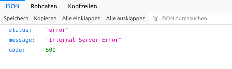

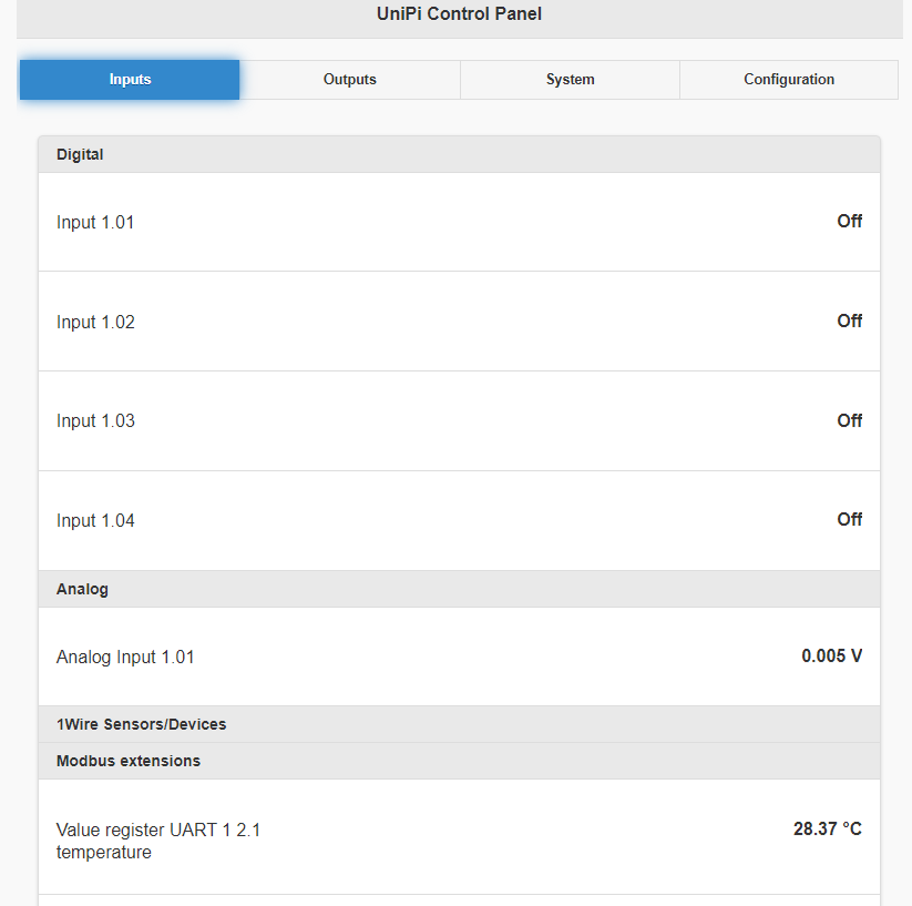

      After that the Extension appear in the EVOK Webfrontend. But when I made a
      http://myunipi/json/all
      I get a:
      Do you have any Idea why? When I uncomment the xG18 section the Server Error disapeer.

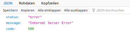

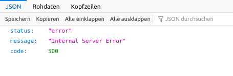

              Hello Martin
              Can we please look at my issue with the Server Error 500 again.
              When restart evok by "sudo service evok restart" the rest API works properly.
              After app. 7s it hangs with Server error 500 as discribed above.

                I was able to narrow down the problem further and I think the following error messages in the nginx.log are triggered when the server error 500 occurs:
                xy@sps:/var/log/nginx $ cat error.log
                2021/07/01 23:05:44 [alert] 1321#1321: *1 open socket #12 left in connection 2
                2021/07/01 23:05:44 [alert] 1321#1321: *2 open socket #13 left in connection 3
                2021/07/01 23:05:44 [alert] 1321#1321: *3 open socket #14 left in connection 4
                2021/07/01 23:05:44 [alert] 1321#1321: *4 open socket #15 left in connection 5
                2021/07/01 23:05:44 [alert] 1321#1321: aborting
                As soon as I comment out the xG18 in the evok.conf, the error messages are gone and the server runs perfectly.
                  Martin Kudláček last edited by
                  Hi @Stoeffel ,
                  I tried to reproduce the error, but without any luck. I used:
                  Neuron S103
                  This OS image: https://kb.unipi.technology/_media/files:software:os-images:neuron-opensource-os_image-20210426.0.zip
                  Then I installed evok (apt update && apt install evok -y)
                  Replaced the /etc/evok.conf with the one you provided
                  Rebooted the PLC
                  The Evok starts without any problem and I can see the temperature:
                  Can you please try the procedure from above?

                    And <IP_Neuron>/josn/all shows correct values? Or Server Error 500?
                    In the Webfrontend of evok I have also correct values.
                    Stefan

                      Stoeffel last edited by
                      Hello Martin
                      Here's what I did:
                      • Downloaded your image and copied it to a new SD card.
                      • Set network parameters.
                      • Logged in via ssh and executed the following:
                        sudo apt-get update && sudo apt-get upgrade
                        sudo apt-get install evok
                      check if evok frontend is running --> okay
                      check if <IP>/json/all is running --> okay
                      • Configure xG18 in evok.conf (version above)
                      • restart evok
                      check if <IP>/json/all is running --> Server Error 500
                      If its easier I can open a Open VPN vor you to the Neuron for debugging.

                              Hello Martin
                              I updated to 2.4.8. I can't see any difference. The problem is the same.
                              <IP>/json/all:
                              Also Modbus stops working after 1-5min. (Rx Tx stop blinking)
                              <IP>/rest/all works properly.
                              Greetings Stefan

                                  [E 210721 21:39:38 web:1591] Uncaught exception GET /rest/all (127.0.0.1)
                                      HTTPServerRequest(protocol='http', host='192.168.1.70:80', method='GET', uri='/rest/all', version='HTTP/1.0', remote_ip='127.0.0.1', headers={'Sec-Gpc': '1', 'Accept-Language': 'de-CH', 'Accept-Encoding': 'gzip, deflate', 'Host': '192.168.1.70:80', 'Accept': 'text/html,application/xhtml+xml,application/xml;q=0.9,image/webp,*/*;q=0.8', 'User-Agent': 'Mozilla/5.0 (X11; Ubuntu; Linux x86_64; rv:90.0) Gecko/20100101 Firefox/90.0', 'Connection': 'close', 'Upgrade-Insecure-Requests': '1'})
                                      Traceback (most recent call last):
                                        File "/opt/evok/local/lib/python2.7/site-packages/tornado/web.py", line 1510, in _execute
                                          result = method(*self.path_args, **self.path_kwargs)
                                        File "/opt/evok/lib/python2.7/site-packages/evok/evok.py", line 1591, in get
                                          result += map(lambda dev: dev.full(), Devices.by_int(UNIT_REGISTER))
                                        File "/opt/evok/lib/python2.7/site-packages/evok/evok.py", line 1591, in <lambda>
                                        File "/opt/evok/lib/python2.7/site-packages/evok/neuron.py", line 1655, in full
                                          'value': (self.regvalue()),
                                        File "/opt/evok/lib/python2.7/site-packages/evok/neuron.py", line 1593, in <lambda>
                                          self.regvalue = lambda: (self.arm.neuron.modbus_cache_map.get_register(1, self.valreg, unit=self.arm.modbus_address, is_input=_is_iput)[0] * self.factor) + self.offset
                                        File "/opt/evok/lib/python2.7/site-packages/evok/neuron.py", line 55, in get_register
                                          raise Exception('No cached value of register %d on unit %d - read error' % (counter, unit))
                                      Exception: No cached value of register 8 on unit 1 - read error
                                  [E 210721 21:39:38 web:2064] 500 GET /rest/all (127.0.0.1) 44.95ms
                                  [E 210721 21:39:42 web:1591] Uncaught exception GET /rest/all (::1)
                                      HTTPServerRequest(protocol='http', host='192.168.1.70:80', method='GET', uri='/rest/all', version='HTTP/1.0', remote_ip='::1', headers={'Sec-Gpc': '1', 'Accept-Language': 'de-CH', 'Accept-Encoding': 'gzip, deflate', 'Host': '192.168.1.70:80', 'Accept': 'text/html,application/xhtml+xml,application/xml;q=0.9,image/webp,*/*;q=0.8', 'User-Agent': 'Mozilla/5.0 (X11; Ubuntu; Linux x86_64; rv:90.0) Gecko/20100101 Firefox/90.0', 'Connection': 'close', 'Upgrade-Insecure-Requests': '1'})
                                  [E 210721 21:39:42 web:2064] 500 GET /rest/all (::1) 15.39ms
                                  [E 210721 21:39:50 web:1591] Uncaught exception GET /json/all (127.0.0.1)
                                      HTTPServerRequest(protocol='http', host='192.168.1.70:80', method='GET', uri='/json/all', version='HTTP/1.0', remote_ip='127.0.0.1', headers={'Sec-Gpc': '1', 'Accept-Language': 'de-CH', 'Accept-Encoding': 'gzip, deflate', 'Host': '192.168.1.70:80', 'Accept': 'text/html,application/xhtml+xml,application/xml;q=0.9,image/webp,*/*;q=0.8', 'User-Agent': 'Mozilla/5.0 (X11; Ubuntu; Linux x86_64; rv:90.0) Gecko/20100101 Firefox/90.0', 'Connection': 'close', 'Upgrade-Insecure-Requests': '1'})
                                        File "/opt/evok/local/lib/python2.7/site-packages/tornado/web.py", line 1512, in _execute
                                          result = yield result
                                        File "/opt/evok/local/lib/python2.7/site-packages/tornado/gen.py", line 1055, in run
                                          value = future.result()
                                        File "/opt/evok/local/lib/python2.7/site-packages/tornado/concurrent.py", line 238, in result
                                          raise_exc_info(self._exc_info)
                                        File "/opt/evok/local/lib/python2.7/site-packages/tornado/gen.py", line 307, in wrapper
                                          yielded = next(result)
                                        File "/opt/evok/local/lib/python2.7/site-packages/tornado_json/schema.py", line 160, in _wrapper
                                          output = rh_method(self, *args, **kwargs)
                                        File "/opt/evok/lib/python2.7/site-packages/evok/evok.py", line 1540, in get
                                        File "/opt/evok/lib/python2.7/site-packages/evok/evok.py", line 1540, in <lambda>
                                  [E 210721 21:39:50 web:2064] 500 GET /json/all (127.0.0.1) 23.83ms

                                      [E 210723 07:08:02 web:1591] Uncaught exception GET /json/all (::1)
                                          HTTPServerRequest(protocol='http', host='l403-sn141.local:80', method='GET', uri='/json/all', version='HTTP/1.0', remote_ip='::1', headers={'Accept-Language': 'en-us', 'Accept-Encoding': 'gzip, deflate', 'Host': 'l403-sn141.local:80', 'Accept': 'text/html,application/xhtml+xml,application/xml;q=0.9,*/*;q=0.8', 'User-Agent': 'Mozilla/5.0 (Macintosh; Intel Mac OS X 10_15_7) AppleWebKit/605.1.15 (KHTML, like Gecko) Version/13.1.3 Safari/605.1.15', 'Connection': 'close', 'Upgrade-Insecure-Requests': '1'})
                                            File "/opt/evok/lib/python2.7/site-packages/evok/neuron.py", line 1654, in full
                                            File "/opt/evok/lib/python2.7/site-packages/evok/neuron.py", line 1592, in <lambda>
                                      [E 210723 07:08:02 web:2064] 500 GET /json/all (::1) 28.64ms

                                          [E 210723 14:58:26 web:1591] Uncaught exception GET /json/all (::1)
                                          [E 210723 14:58:26 web:2064] 500 GET /json/all (::1) 26.74ms

                                          [E 210723 14:58:33 web:1591] Uncaught exception GET /rest/all (::1)
                                              HTTPServerRequest(protocol='http', host='l403-sn141.local:80', method='GET', uri='/rest/all', version='HTTP/1.0', remote_ip='::1', headers={'Accept-Language': 'en-us', 'Accept-Encoding': 'gzip, deflate', 'Host': 'l403-sn141.local:80', 'Accept': 'text/html,application/xhtml+xml,application/xml;q=0.9,*/*;q=0.8', 'User-Agent': 'Mozilla/5.0 (Macintosh; Intel Mac OS X 10_15_7) AppleWebKit/605.1.15 (KHTML, like Gecko) Version/13.1.3 Safari/605.1.15', 'Connection': 'close', 'Upgrade-Insecure-Requests': '1'})
                                          [E 210723 14:58:33 web:2064] 500 GET /rest/all (::1) 11.47ms
                                          [E 210723 14:58:33 web:2064] 500 GET /rest/all (::1) 11.42ms
                                          • S
                                            Hello Martin
                                            I hope I have solved the problem now. My Modbus and Json/Rest have been running error-free for 24 hours.
                                            I have done the following:
                                            • Update EVOK to 2.4.10
                                            • Deactivated the Modbus device in FHEM
                                            • The Modbus is now only addressed via the Neuron Device in FHEM.
                                            The access to the Modbus is realised with Fhem on the one hand via the Device Neuron and on the other hand via the Device Modbus. If both are installed, there will probably be conflicts which cause EVOK to crash. In any case, it was possible to get the system running again for a while by restarting EVOK.
                                            After deactivating the Modbus device in Fhem, I no longer had any error messages in EVOK. However, after 2 hours, the Modbus hung up again. Then I updated EVOK to 2.4.10 and rebooted everything. Since then, the system has been running error-free for 24 hours.
