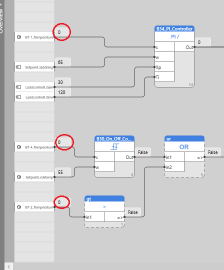

      I have a big problem
      my one wire mesh dies at regular intervals
      it shows 0 value and in order to get it back so it is enough to remove the plug from unipi and put it in again
      or restart the RPI.
      I have 10 pieces of sensors in my net
      It is possible to drive outputs and analog out works but not one wire
      10 pcs sensors too much to connect to unipi
      My net is about 10 m long using Cat 5 cable

                                      My 1-wire is incredibly unstable
                                      network dies at irregular intervals, showing unreasonable temperatures.
                                      I have rebuilt my net for spec from Unipi wiki shielded cat5 cable and hubs.
                                      But no difference 1-wire network die anyways.
                                      So it can not be anything wrong with the network itself, but the fault must be in Unipi alt. software.
                                      Grateful for help .

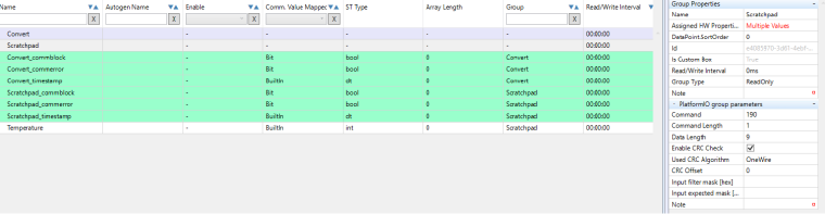

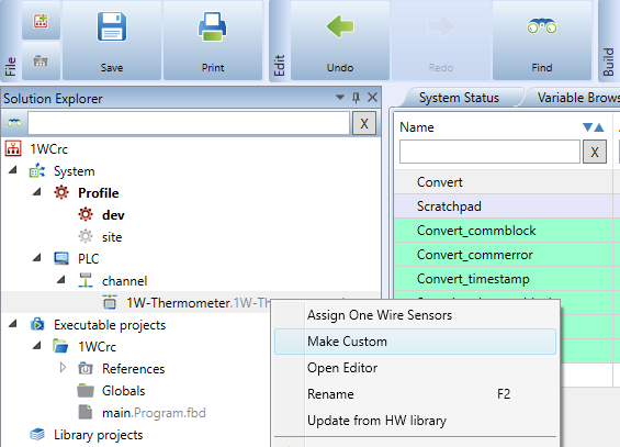

                                        @zorro_66 Can you try enabling the CRC check at the sensors? Just check the box in the sesors in the Scratchpad group. You might need to make the sensor as a custom and backup your project before playing with it
                                        • zorro_66
                                          zorro_66 last edited by
                                          I do not understand what you mean now
                                          T 1 Reply Last reply Reply Quote 0
                                            tomas_hora administrators @zorro_66 last edited by
