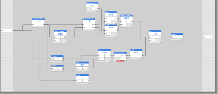

                Giamba last edited by Giamba
                With the following program, If I "short" push the button, the final out value goes 0 or previous analog value. If I "long" push the button the value increase or decrease.
                So I have short and long push detection and a toggled output.
                This is working pretty well with 50% ratio.
                John-paul 2 Replies Last reply Reply Quote 0

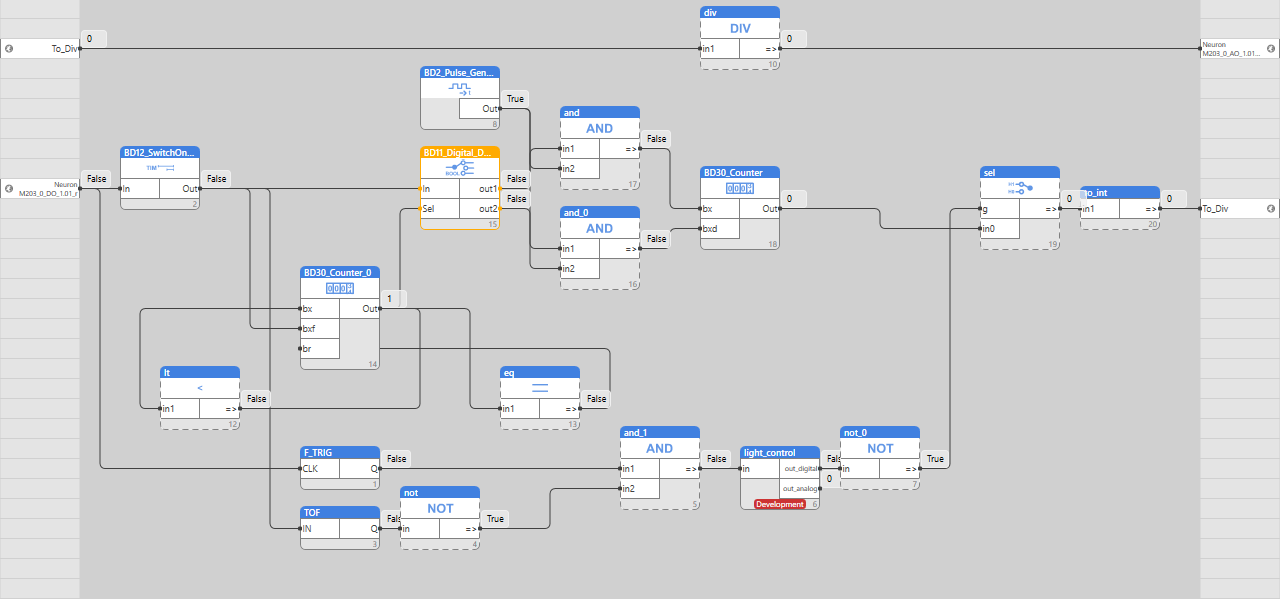

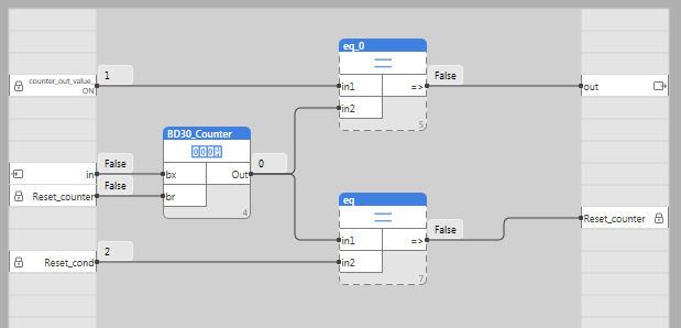

                • G
                  Hi again,
                  This is my On/Off switch (allways as a fonction block in fdb mode):
                  • K

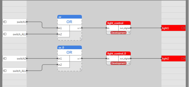

                                    msoenen last edited by
                                    Thank you for the answer, but for my home automation project, I wanted to
                                    activate my lamps with pushbuttons ( this OK) and a button to disable all RO at the same time
                                    how to do?
                                    T 1 Reply Last reply Reply Quote 0

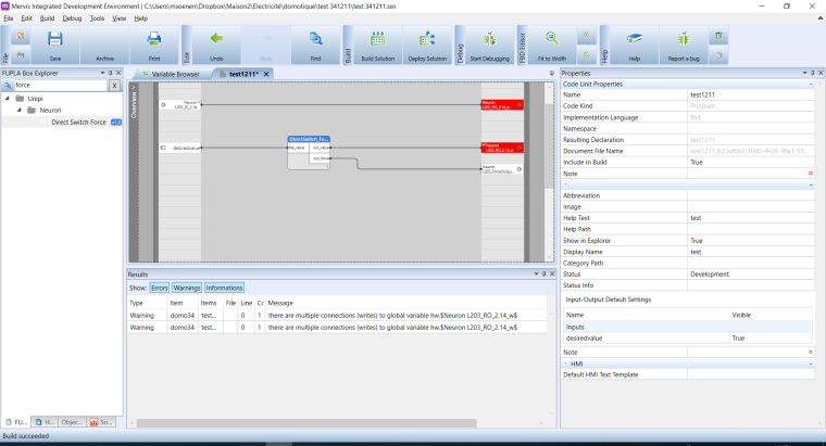

                                      tomas_hora administrators @msoenen last edited by
                                      @msoenen Then check the "DirectSwitch_force" and its documentation which is part of Lib.UniPi
                                      M 1 Reply Last reply Reply Quote 0
                                        msoenen @tomas_hora last edited by
                                        @tomas_hora Hello, this is the function I'm looking for, but I do not really understand how to do the program in input. would you have an example of a program with this function?
                                        thank you in advance
                                          @msoenen Just the picture in the help of Mervis.. There is actually not much to show.
                                            Hello sorry, I am beginner on unipi.
                                            when I do exactly like help, it does not work, it must miss a configuration
                                            Thank you for your help
