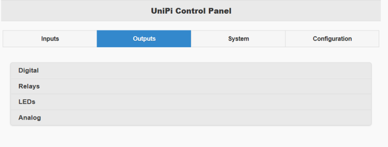

      I have installed the Image Unipian-Neuron-OS-2018-92-26 to test th Modbus-TCP
      After Startup I try to connect to the Neuron M10x with a browser
      I can't see the Inputs and Outputs
