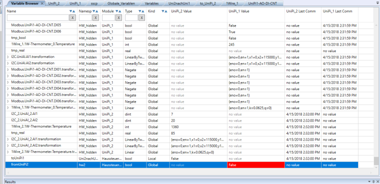

                  I tried it again with the newer runtime, also adjusted the IP setting and simplified the program to an unidirectional communication from PLC2 to PLC1.
                  The result is: no longer error messages, only fault is that the variable (fromUniPi2) at PLC1 which I want to change via PLC2 is now marked in red. I declared it in the Globals, with and without any namespace but no success. Is there a trick/another fault?
                  0_1523796262912_upload-069394ea-a155-443e-aec0-e9f669828709
                  Thx
                  CB

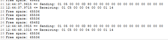

                        As seen in https://kb.mervis.info/lib/exe/fetch.php/cs:mervis-ide:sharkprotocolspecification_user_2017_05_30.pdf,
                        In port monitor:
                        On receiving:
                        • 01 SSCP address
                        • C5 00 Read variables directly error
                        • 00 04 Data length
                        • 00 00 01 14 NotLogged
                        So I have a resonse, credentials seems too be wrong, but I have admin - rw on PLC configuration and SSCP Device.
                        Do you have an explanation ?

                            CKB last edited by CKB
                            I read the same information in my port monitor
                            0_1525862822076_upload-e0197090-947e-4378-8228-6aed04a8d5a8
