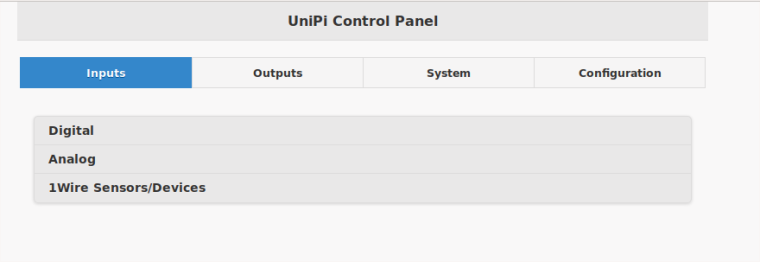

      I just installed Evok 2.0.5a on a freshly installed Raspbian (Neuron M103). I can access the Web-Frontend through http://hostname.of.neuron but it does not show any items. See screenshot:
      Logfile say Python tracebacks:
      2018-05-02 13:50:48,586 - evok - ERROR - 'NoneType' object has no attribute 'do_scan'

      After the installation I waited always several minutes before rebooting and already rebooted several times. Noch change.
      dmesg| grep -i neuron
      does not give any output.
      Any clues?

        Could you post the output from "systemctl status neurontcp"? It could help us diagnose the issue further.
        Regardless, it looks like the installation did not finish correctly for some reason. You could try using the UniPi OpenSource image instead of Raspbian, from https://files.unipi.technology/s/public?path=%2FSoftware%2FOpen-Source Images. It is really just standard Raspbian anyhow, but it comes with EVOK and our kernel drivers preinstalled.
