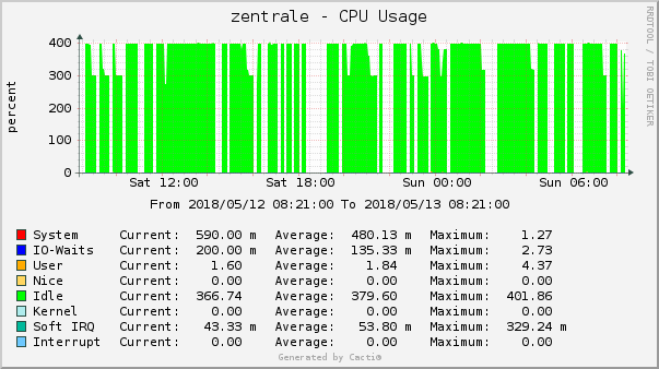

      I use one of the DIs of my neuron an I am counting the impulses. As I am collecting the data through snmp I installed snmpd. But as access to /sys/... is only allowed for root (and snmpd not running as root) I created a wrapper-script:
      #!/bin/bash
      [ -x /tmp/neuron ] || mkdir -p /tmp/neuron
      for i in 1 2 3 4 ; do
      	/bin/cat /sys/devices/platform/unipi_plc/io_group1/di_1_0$i/counter > /tmp/neuron/1_0$i
      done
      for i in 1 2 3 4 5 6 7 8 ; do
      	/bin/cat /sys/devices/platform/unipi_plc/io_group2/di_2_0$i/counter > /tmp/neuron/2_0$i
      done
      Which gets started by crontab.
      Now the issue:
      When I run the script every minute, my Neuron gets completely unstable. It reboots every now and then, when I ask for uptime it is only rarely more then 10 minutes!
      I do not see any reasons for a reboot in the logs, but it reboots. You can recon the reboots every time my Cacti (through snmp) does not get CPU data:
      When I change the crontab entry from minutely to every five minutes it works.

                I will test this tomorrow. Today I changed my script so it is not accessing the /sys any more and instead just adds +1 every run. Set to minutely. If the system still reboots it might not be related to /sys access. Up to now it did not reboot (4hrs now stable).
                When I am done with this test I will start your script- will be tomorrow.

                    No reboot the last 24hrs. Looks like it is really related to accessing /sys.
                    I will use your modified version now and monitor at least the next 24hrs.
