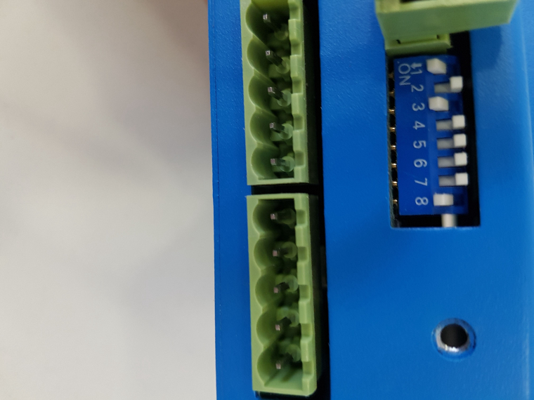

                            Then connect the line and set the dip switches to the following positions:
                            (apologies for the rotation)
                            I have verified that these settings work with a fresh EVOK install, with the device in the photo.

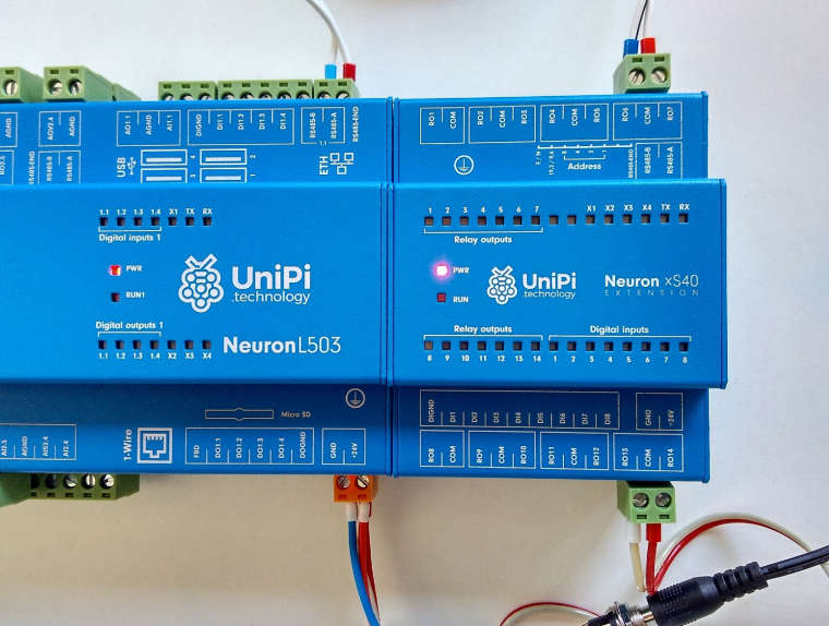

                            • B
                              Boy Lenssen @TomasKnot last edited by Boy Lenssen
                              @TomasKnot Hey, thanks a lot! I got it working now. I think I might have forgotten to remove the semi-colon before [EXTENSION 1] :face_palm:
                              Now the Rx light on the xS40 is now constant on, the run light is still going on / off every 2 seconds. On the neuron, the TX flashes on very swiftly.
