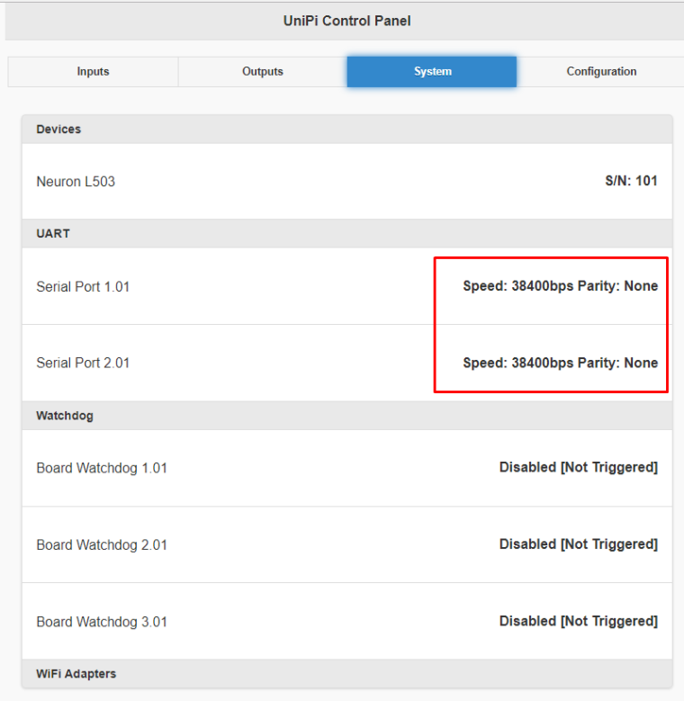

          Second option is to set this via EVOK's API and this works even when you are running EVOK on the Raspbian image. The simplest way is to open the EVOK's WEB UI and click on System on the top menu. You should see similar interface:
        As you can see, I have 2 RS485 ports on my L503 and both are configured as 38400 with no parity. To change the settings, click on the Configuration in the top menu. On the configuration page click on the serial port button you want to change:
        A serial port configuration dialog will appear and you can set all the parameters. Change them according to your UniPi Extensions and confirm by clicking on Submit.
        The configuration dialog will be closed. Now you need to save the changed settings by clicking on the Save current state to Flash.
        And that's it. You should by able to see the extension's ports in the UI as well after reboot.

                      1. After restarting the evok (service restart evok), the devices and their inputs/outputs were immediatelly available in the Web UI:
                      0_1531147081348_FireShot Capture 1 - UniPi Control Panel - http___192.168.221.95_.png
                      Can you check your setup against mine above? Try simplifying the extension's configuration as I did.
                      M.
