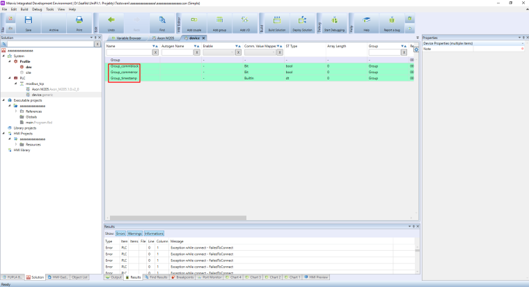

        If so, each Modbus group of elements has so called "attributes", which are special variables, which for example tell you when the last communication occured, and what is the last state of the communication exchange:
        What you are probably looking for is the _commerror variable. When true, the current value in all the elements is not correct, since the communication is broken. If false, the values are correct.
        Include this _commerror variables into your program to detect and work around the communication errors.
