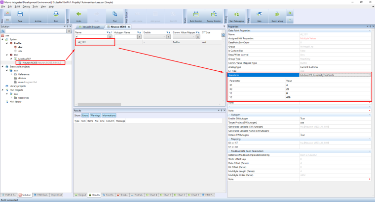

      Hello @r3sist,
      for this type of recalculation you can use "transformation". Transformations are built-in functions for recalculating the measured value and you can configure them for each input.
      Your sensor outputs 4mA when the pressure is 0 bar nad 20mA when the pressure is 400 bar. You can use transformation "LinearByTwoPoints", via which you define line on the graph by two points: X1, X2, Y1 and Y2.
      For first measured value (X1) in mA, you define what value you want (Y1). So for X1 = 4, you want Y1= 0. The same you will do for X2 = 20, Y2 = 400.
      Here is where to configure this:
      After this configuration, you need to upload the configuration to the module: https://kb.unipi.technology/en:sw:01-mervis:unipi-configure-module-hidden

        @martin-kudláček Very detailed tips, i found the setting immediately. I lost myself while looking for parameters under Variable Browser.
        I applied the transformation, first at Analog Type - > Current, i've set the points just like u said, but...
        Not sure, but 95% that my sensor is dead, cause the PLC Value reading was oscillating between 0.0078 to 0.0106 or something, the exact same reading is shown when there is nothing wired to the AI1.1/AGND on open contacts.
        I will try to check the pressure sensor alone, ordered another new one, and I will post back the results on a new sensor.
        Thanks a lot for help, will come back to this topic after it arrives.

          Hi @r3sist, did you configure the module? It looks like you still have the AI in the voltage mode, hence the low readings.
          R 2 Replies Last reply Reply Quote 0
            r3sist @Martin Kudláček last edited by
            Hi @martin-kudláček, yes, i did reconfigure the module, even twice, trying to swap between the sensor's voltage and current output, with the same result.
