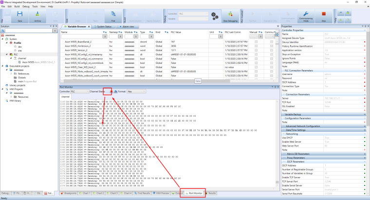

      Is there any method to view the ModBus queue for error analysis. Any sniffer for /dev/ttyS1 device?
        Martin Kudláček @BeerGeek last edited by
        Hello @beergeek, yes it is. Start the debugging mode, switch the bottom panel to "Port monitor", select the channel you want and press "play". You will see the Modbus requests and (hopefully) some responses:
