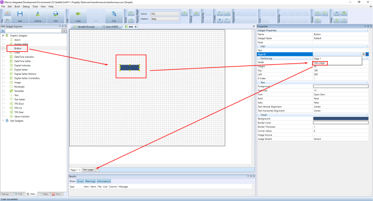

      i'm pretty new to HMI editor in Mervis.
      But i want to link another HMI Template (page) from button in another Template.
      Example:
      Template "Heating" and i want to have on this page Button, which links me to template "Heating SetUp".
      How to do this?
        Martin Kudláček @JakubCh last edited by
        Hello @jakubch,

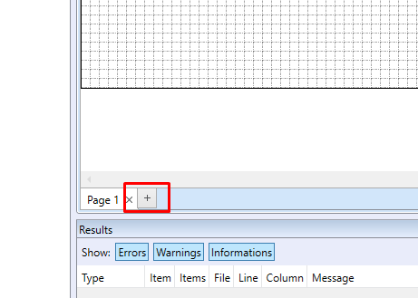

        you need to create another page in the same template by clicking on the '+' button:
        And in the template itself, use the "Button" HMI object:
        1 Reply Last reply Reply Quote 1

          On my screen the + is to the far right, and it only works on HMI Projects
            Martin Kudláček @soren last edited by
            Hello @soren,
            that looks like you are using Mervis IDE 2.1.3. If you can, please upgrade to the 2.2.0.
