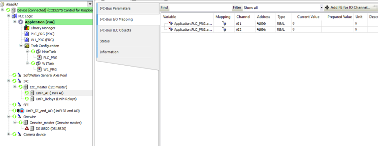

      Hello I followed the 2 pdf of configuration
      All other IO are working well.
      1-
      I m using 2 REAL variabiles ana1 , ana2
      I applied 5 V dc between AI+ and AI-
      The AI1 and AI2 show always 0 volts...
      Why ?

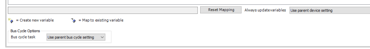

      Here the settings for cycle..
      2- How to enable de DI 13 and 14? Have I to change some dip switch? or SW?
      Thanks
      • F
        FabioIT last edited by
        Hello I tried to do a clean all and now is working.
