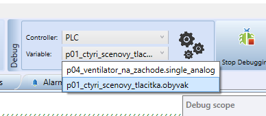

      When I go into debug mode I can no longer see the variable values in the fbd or st file viewers. The variables do show in the Variable Browser. Any ideas?

          are you sure you have selected the actual instance of the FB?
          The debugging of ST code is quite "buggy". On many occasions, the values are not shown or are incorrect. We are working on a fix.
            Matt last edited by
            The controller was not selected. It's working now. Thank you for pointing that out.
