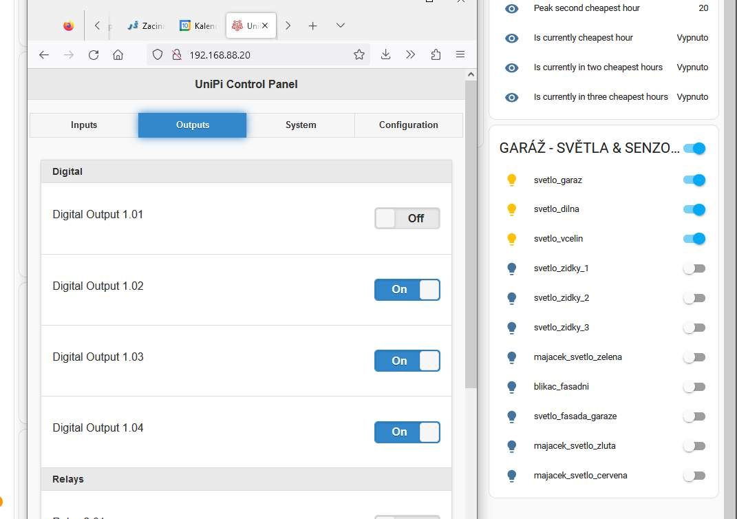

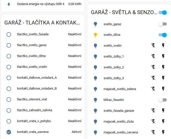

                    petr.skvor last edited by
                    hi @marko2276,
                    Thank you for sharing your integration.
                    I am a beginner and now I used it for HA communication with NEURON M203 via EVOK layer. Installation of the integration and configuration of the LIGHT sensors (I used for DO and RO outputs) are fast and functional. Turning on/off the relay on M203 has a small response:
                    When I added the BINARY sensors (DI) configuration, the problem already arose => LIGHTs do not work at 100%:
                    I always check the configuration in Developer Tools before restarting HA:
                    #UNIPI NEURON via EVOK
                    unipi_neuron:
                      - name: "neuron5"
                        type: M203
                        ip_address: 192.168.88.20
                        reconnect_time: 30
                    light:
                      - platform: unipi_neuron
                        device_id: "neuron5"
                        devices:
                        - name: svetlo_garaz
                          device: relay
                          mode: "on_off"
                          port: "1_02"
                        - name: svetlo_dilna
                          device: relay
                          mode: "on_off"
                          port: "1_03"
                        - name: svetlo_vcelin
                          device: relay
                          mode: "on_off"
                          port: "1_04"
                        - name: svetlo_zidky_1
                          device: relay
                          mode: "on_off"
                          port: "2_05"
                        - name: svetlo_zidky_2
                          device: relay
                          mode: "on_off"
                          port: "2_06"
                        - name: svetlo_zidky_3
                          device: relay
                          mode: "on_off"
                          port: "2_07"
                        - name: majacek_svetlo_zelena
                          device: relay
                          mode: "on_off"
                          port: "2_08"
                        - name: blikac_fasadni
                          device: relay
                          mode: "on_off"
                          port: "2_11"
                        - name: svetlo_fasada_garaze
                          device: relay
                          mode: "on_off"
                          port: "2_12"
                        - name: majacek_svetlo_zluta
                          device: relay
                          mode: "on_off"
                          port: "2_13"
                        - name: majacek_svetlo_cervena
                          device: relay
                          mode: "on_off"
                          port: "2_14"
                    binary_sensor:
                        devices:
                          - name: tlacitko_svetlo_fasada
                            device: input
                            port: "1_01"
                          - name: tlacitko_svetlo_garaz
                            device: input
                            port: "1_02"
                          - name: tlacitko_svetlo_dilna
                            device: input
                            port: "1_03"
                          - name: tlacitko_svetlo_vcelin
                            device: input
                            port: "1_04"
                          - name: kontakt_dalkove_ovladani_A
                            device: input
                            port: "2_01"
                          - name: kontakt_dalkove_ovladani_B
                            device: input
                            port: "2_02"
                          - name: tlacitko_otevreni_vrat
                            device: input
                            port: "2_03"
                          - name: tlacitko_zahradni_zalivka
                            device: input
                            port: "2_04"
                          - name: kontakt_vrata_v_pohybu
                            device: input
                            port: "2_05"
                          - name: kontakt_vrata_zavrena
                            device: input
                            port: "2_06"
                          - name: kontakt_vrata_otevrena
                            device: input
                            port: "2_07"
                          - name: kontakt_vrata_prekazka_v_zavreni
                            device: input
                            port: "2_08"
                          - name: tlacitko_opusteni
                            device: input
                            port: "2_09"
                          - name: kontakt_PIR_osoba_vgarazi
                            device: input
                            port: "2_10"
                          - name: kontakt_kour_v_garazi
                            device: input
                            port: "2_11"
                    Could you advise me where the problem could be?
                    I would also like to use this integration on the NEURON L303 and L403, where I have connected analog inputs, analog outputs, and 1-Wire temperature, humidity, and lighting sensors. Will you please complete the configuration for these mentioned inputs and outputs as well?
                    I look forward to your reply
                    Petr
