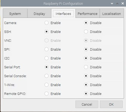

      I've noticed that after installing EVOK, I2C is disabled on Raspbian, but still I can communicate with I2C devices.
      I2C disabled in RP4 settings:

      I wonder how this is possible. Is there some electronic element, which is handing I2C communication on UniPi 1.1? If yes, what is default speed of it?
        Martin Kudláček @mglowinski last edited by
        Hi @mglowinski,
        the I2C is enabled in a standard way by device tree overlays. The tool you are using (Raspberry Pi Configuration) probably expects the settings in their own way and don't understand the ours.
