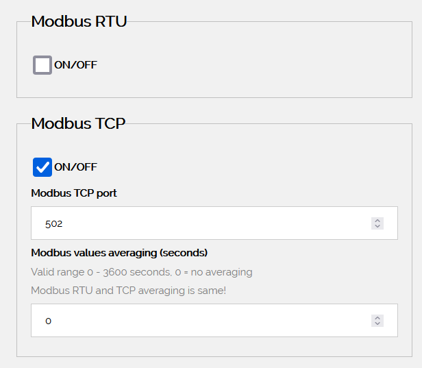

      may be am am a little bit stupid. But I do not get any modbus information back from my new device.
      These are the settings of the device:
      I verified the port is open:

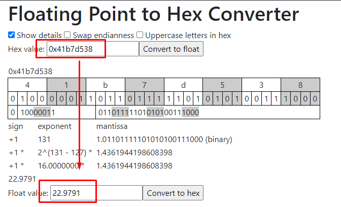

        root@mkudlacek:~# mbpoll 192.168.218.249 -a 1 -0 -1 -r 0 -c 2 -t 3:hex
        mbpoll 1.4-25 - FieldTalk(tm) Modbus(R) Master Simulator
        Copyright © 2015-2019 Pascal JEAN, https://github.com/epsilonrt/mbpoll
        This program comes with ABSOLUTELY NO WARRANTY.
        This is free software, and you are welcome to redistribute it
        under certain conditions; type 'mbpoll -w' for details.
        Protocol configuration: Modbus TCP
        Slave configuration...: address = [1]
                                start reference = 0, count = 2
        Communication.........: 192.168.218.249, port 502, t/o 1.00 s, poll rate 1000 ms
        Data type.............: 16-bit register, input register table
        -- Polling slave 1...
        [0]:    0x41AD
        [1]:    0x05FD
        The problem is probably in the slave address. You probably use "0" (modbus_set_slave(modbus, 0)), but it is "1".
