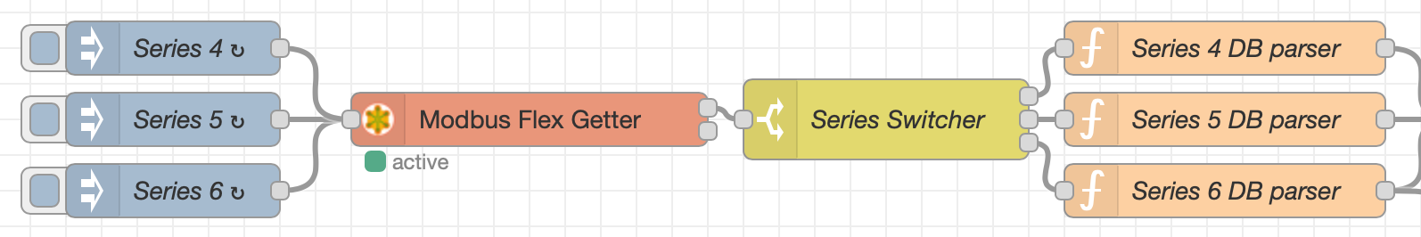

      I had ordered successor to PRO380 meter and I had hard time connecting it to my smart home. I tried multiple things for 10 straight hours without any luck, until suddenly realised that the addresses in the manual are in HEX and not DEC that modbus works with. So for the future generations I would like to share my solution here.
      I have created flow in NodeRED to read most of the data (these that make sense to store in database and show in Grafana), I try to read the data using most efficient approach with just one modbus flex getter node that can handle it's queue correctly and then 3 functions to parse the data and format it into the object to pass to InfluxDB batch node. But you can alter it in any way that would work for you. The function also solves translating HEX data to correct floats, ASCII or signed int's.
      I have ended up using Modbus TCP x RTU gateway because I struggled to make my UniPi working at that day, but it should work exactly the same with RTU connection from any of UniPi devices running NodeRED.
      Here is the flow:

      Hope this helps, and I will be happy for your feedback.
        AVsetula last edited by AVsetula
        Hi @ArnieX,
        Thank you for your post.
        This is a typical error when setting up communication with INEPRO/KLEFR electricity meters, and it is really necessary to be careful when setting up other devices (modbus tables).
        Antonin, Unipi
