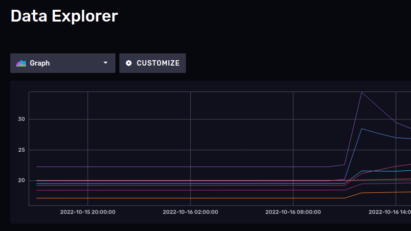

                I have the same problem but I use NodeRed and EVOK API.
                All the sensors connected directly to my Neuron L203 started showing a constant temperature out of nowhere, which was very dangerous. However, the sensors connected via xG18 were showing correctly.
                Since then I restart the evok with cron task every hour just to be safe. systemctl restart evok.
