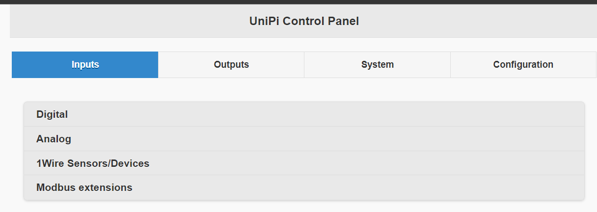

      I just downloaded the neuron-node-red_image-20220412.0 image from the website and flashed it on my neuron S103 (S/N 119).
      It starts up fine, but then I see no inputs or outputs on the evok control panel:
      The log available on the configuration page of the control panel shows these errors:

      The node-red ui itself with the default flow seems fine, but nothing happens when i try to switch a DO on (the led on the neuron does not light up).
      The hardware itself was working fine with a couple-of-years old image, I believe this must be a software issue, nothing should be wrong with the hardware.
      Any ideas?
