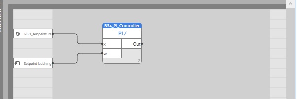

      How do I configure analog out in Mervis
      I use B34 PI controller but which output should I use find no suitable

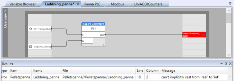

        First of check that you have AO in Variable manager (it is added with the rest of Di,Cnt and others when using UniPi 1) and do all the wiring http://unipi.technology/wiki/Using_Analog_Output
        The value of AO is in milivolts, so you might need to do some calculations in order to get proper levels.
        And simply connect the output of PI via the calculations to the AO variable, (right click on the right pannel->global variables->insert existing

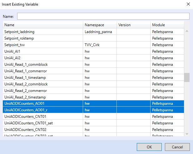

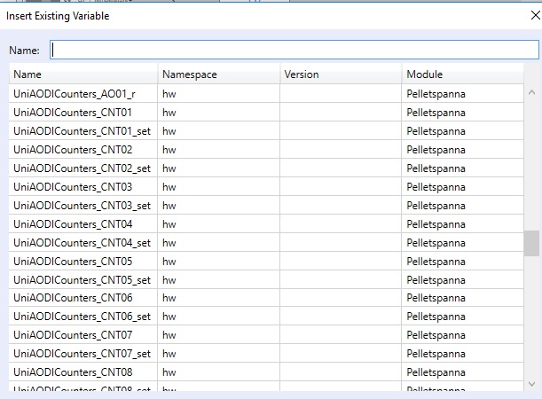

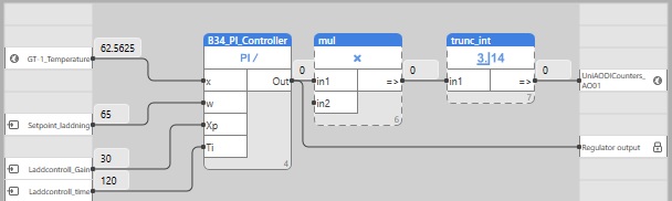

          But what is the name of the output in the variable panel 0_1477043371218_Analog ut1.jpg
            tomas_hora administrators last edited by tomas_hora
            AO01_w is the one you are looking for. W at the end means that the variable is for writing values into, the _r at the end means that is is for reading the actual state.
            • zorro_66
              zorro_66 last edited by
              I can not find _w in my List
              only AO01 and AO01_r
                Sorry, my bad. It is only AO without the R or W...
