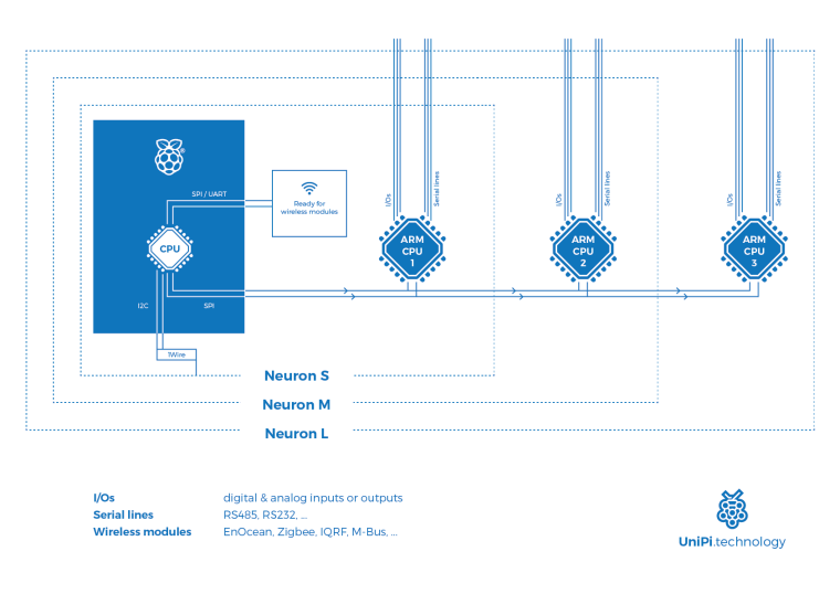

        for better understanding, see this picture:
        This repository https://github.com/UniPiTechnology/neuron_tcp_modbus_overlay contains overlay for the Neuron CPUs to work and also a daemon Modbus TCP Server that provides access to the IOs (except the 1Wire) and also creates a VTY for the serial line. So if you do not want to use Evok, use that or you can also write it on your own if you want.
