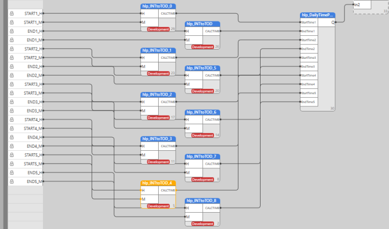

        Hi everybody,
        I have a similar problem. I'm using some TOD-variables to schedule some things. Now I wanted to integrate them in HMI, I tried the approach below. However, I found no possibility to convert TIME to TOD. Can you maybe give a hint?

            robert_n last edited by
            @tomas_hora Unfortunately that did not work for me because I do not use TIME variables, but TIME_OF_DAY. When I try to connect these two types, the compiler throws an error. I found a workaround to convert to TIME_OF_DAY with add_tod_time. This method means a lot of work to program the Function and HMI and it becomes slightly confusing...

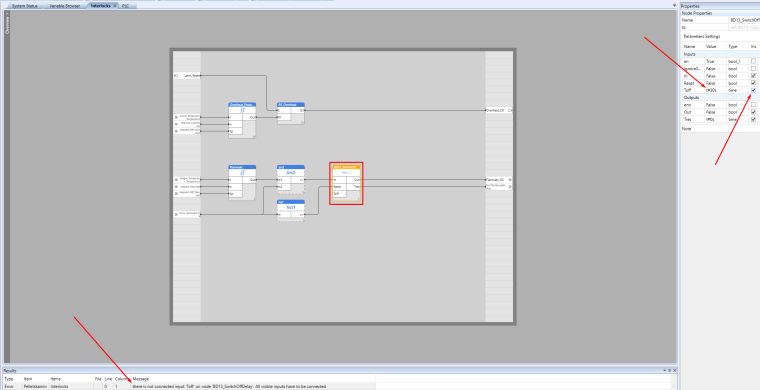

                              tomas_hora administrators @zorro_66 last edited by

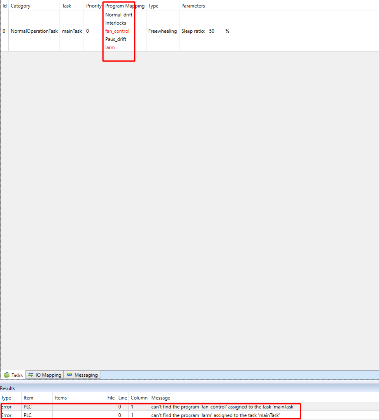

                              @zorro_66 All input variables of a function block has to be connected or checked as not visible and set a default value. That is missing in your BD13_SwitchOffDelay of Interlocks program.
                              The second issue is, that in the PLC program mapping, you have mapped two programs that do not exist...
                              • zorro_66
                                Thanks for the quick reply Tomas
                                Well, I know I had nothing connected to that block but did not think it was the fault.
                                Because it's on the position my time_Converter was supposed to enter.
                                Which two programs have I mapped that are not available
                                  @zorro_66 if you double click on the error in the result table, it will usually show you where the issue is... Or just read what it says.
