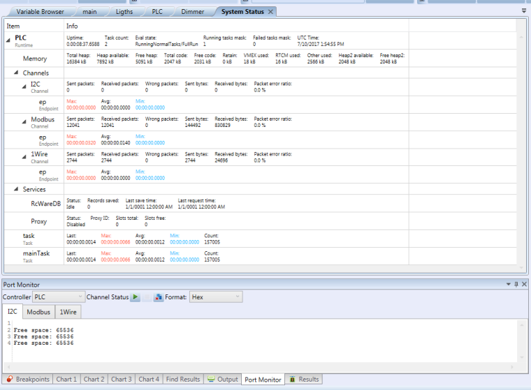

      I have my i2c not working on the unipi v1.1. Relays does'nt work anymore.
      I have no communication in system status -> I2C.
      i2c-detect -y 1 give me:
      root@unipi:~# i2cdetect -y 1

      Version of Mervis IDE is 57589 and the runtime is up to date.
      Please, can someone tell me what's happening ?

          Hi tomas,
          Now I see it's happening only when I add a task with a new fdb program.
          I create a program named "ligths" with just DI1 -> Relay1. I add the task as 50% ratio priority 0, the same as the main.fdb.
          I build, deploy, and there is no more i2c.
          When I remove the task, that's work again!
          Maybe a bug ? What do you think ?

                  If I understand, we can't set multiple "normalOperationTask" because it's impossible to load multiple intances of hardware resources. Tow tasks means two loads of ic2 (and others protocols) witch is impossible beacuse of opening the same port/protocol. So I can't have a multithreading project as one for ligths and one for heating for example. How to do that? If not, by your side, why to not make it possible, by use for example program shared memory for hardward resources instantiations int the RT. Maybe it will be a thing to do. What about it ?

                      My project is at this address: https://we.tl/W7Yzk6xjzw.
                      You can test to remove i2c_test from the main task to put in a new one. When it's done, i2c and 1-wire doesn't work anymore.
