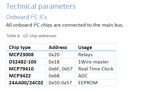

      I'm new to I2C but im looking to plug in a 4 channel dimmer board based on the PCF8574 chip. The addresses it can be set to are:
      // Device address -> 0x27, 0x26, 0x25, 0x24, 0x23, 0x22, 0x21, 0x20
      // Device address -> 0x3F, 0x3E, 0x3D, 0x3C, 0x3B, 0x3A, 0x39, 0x38
      Which would work best with the UniPi?
        tomas_hora administrators @sjp770 last edited by
        @sjp770 I would avoid 0x27, 0x26, 0x25, 0x24, 0x23, 0x22, 0x21, 0x20 because they can be taken by EMO-R8 (0x20 is already taken by the onboard MCP23008). Overview from the documentation: 0_1500358292900_doc_unipi1.png
          Thanks for that, but seeming I wont be using a EMO-R8 anything besides 0x20 in that list is ok?
            @sjp770 Correct :)
