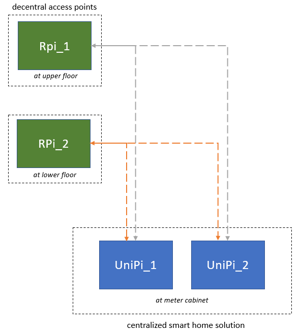

      for a smart home solution I have 2 UniPi's (and a stack of extension boards) as main computing units to automatically control shutters, light, alarms etc.
      In order to enable also manual changes for shutter positions or lights I like to install 2 Raspberry Pi's with a mounted touch panel at central positions - like this:
      0_1502468211471_upload-a86670fc-339a-4a10-bb74-dc884176f596
      The user shall be able to change settings on the UniPi(s) via the RPi or get information from the UniPi(s)
      Like this:
      0_1502468307518_upload-61c8edd7-e24a-41f9-92bd-549cc05ba7dd
      How to realize a bidirectional communication (grey & orange) between RPi's and UniPi's? I2C? Ethernet? ....
