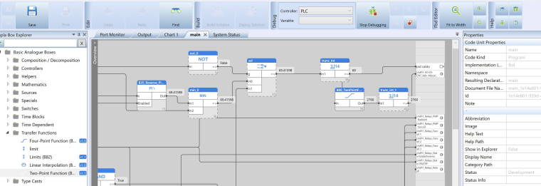

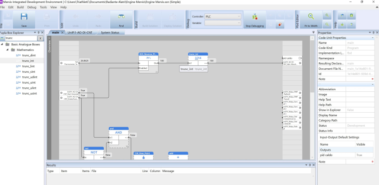

      Good morning I am planning my unipi1. I noticed that after the Fragile Block in Fupla PI..the output can not be directly connected to the AO .. must I switch to a Trunc_int..and well?
      Now I downloaded the program and it seems to work properly .. my dilemma and problem is to understand the AO 0-10V output as it works physically ..
      in logical duty to have as it does photo attach 100% of the signal ie 10v ..
      I connected the negative tester tester to AOG and the positive s AO .. i do not go out of anything ... how ever?0_1504684262353_Cattura.JPG

          Sorry Thomas but I do not understand how to do it .. and the download section documentation I did not find it ..
          you can kindly make me a screen shot with the logic blocks where to put that value thank you.

              @tomas_knot without using the formulas I did a double point function..credo is lost..the problem is that even now with a value of more than 2000 I have nothing on the AOG and AO terminals ..
