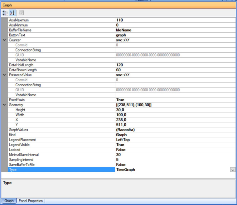

              TriathletC @tomas_hora last edited by
              @tomas_hora
              I do not know how to enter the parameters and where to make a graph .. help me with courtesy. Thank you0_1505227609925_Cattura.JPG
              D 1 Reply Last reply Reply Quote 0
              • D
                David @TriathletC last edited by
                @TriathletC If you want simple graph just in collumn GraphValues click on "(Raccolta)". There Add and Attach variable which you want to show. Necessary is to set Axis Maximum and Axis Minimum. For this reasonis better to use Mervis DB.

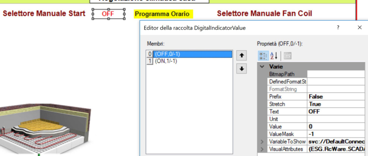

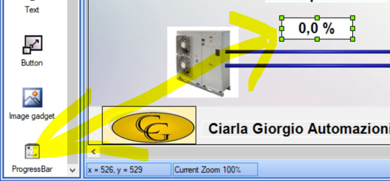

                  Help me..
                  sorry i was making graphics changes..and now the progress bar does not appear to me and i can erroe when i save ..

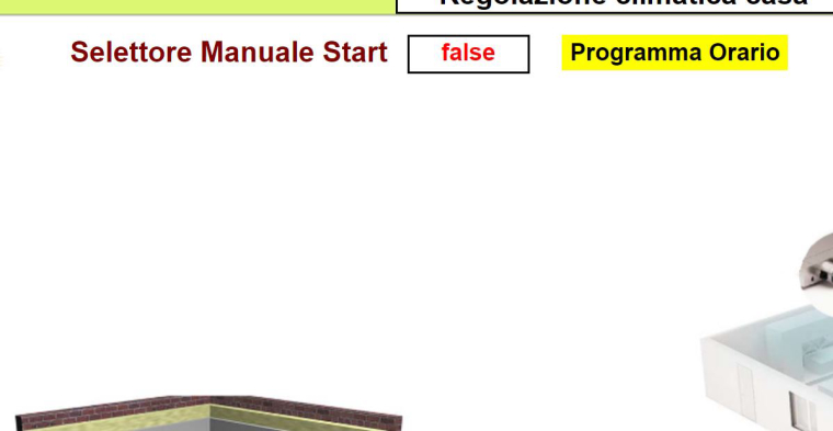

                    @tomas_hora
                    I would like to know some technical information .. Like ever in the HMI study when I program a group to see a state I write in English ..
                    but online gives me the inscription in English?1_1505511316833_Cattura_2.JPG 0_1505511316833_Cattura.JPG
                      @TriathletC Is the variable that you attached the same as variable that you want to see?
                      • D
                        David @TriathletC last edited by David
                        @TriathletC And to your first query I think that best way will be to reinstall HMI. Because it's hard to say what you've changed and transcribed.
