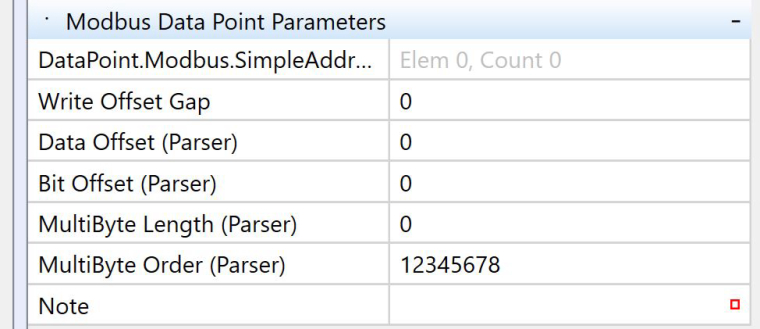

      Hello, I need a help to connect a third party device that communicates in mobdus TCP.
      The device has an IP address of 192.168.1.75
      service port 502
      now i do not know how to configure it in mervis .. because it gives me error .. i attach it ..
      I do not understand where I'm wrong
      Then I would like to know one thing .. how to create the modbus addresses where the UNIPI read or write an analog input 0-10v and output relays ..
      is there a small tutorial per case?

        @TriathletC Hi, how i see on picture, you don't have added your PLC at Modbus_Tcp's channel. Also you have to be in Advanced mode. You can get to this mode by Right click on 'Prova' and switch to Advanced mode. To your second query you can try to look on tutorials on youtube:
        https://www.youtube.com/watch?v=SiepuniJDBQ
        https://www.youtube.com/watch?v=yGHDOw28pfI

          The problem with using my unipi .. the modbus connection with the third part is in TCP and not on two wires like the Neuron ..
          Now I do not understand how to set the Modbus Data Point Parameter data ..
            tomas_hora administrators @TriathletC last edited by
            @TriathletC The principle in creating description of third party modbus devices is the same. Also chekc the Help of Mervis (F1) and search for Modbus driver
