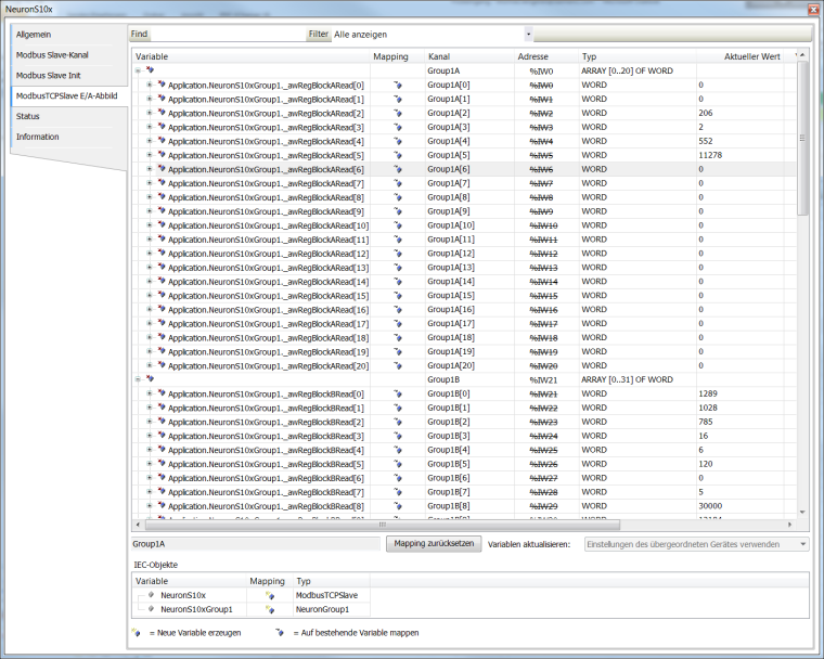

                        I should be able top track back and see what is happening if I can see the values of the Group1 registers. Please post images of the values of the Group1A and Group1B mappings page while the system is running with a known rValue.
                        If you want me to have a quick look at your application then please contact me via https://www.cososo.co.uk/contact/.
                          tom84 last edited by

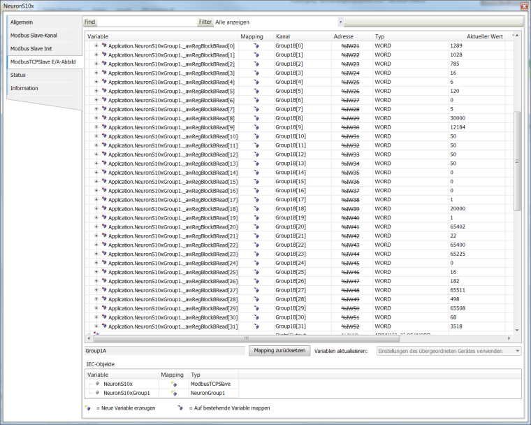

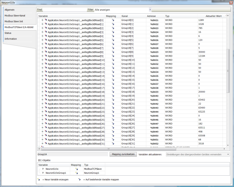

                          the load is an industrial isolation barrier. all measurements where done with the barrier disconnected and an amperemeter connected directly to the Neuron.
                          for test purposes I decided to download the demo application to my device. It is made for S10x and I am running it on a M203, but it shows the same behaviour:
                          rValue=0:
                          rValue=20:
                          rValue=157:
                          D 1 Reply Last reply Reply Quote 0
                            DavidCozens @tom84 last edited by
                            @tom84
                            The mA problem is an issue with older hardware. UniPi Neuron for CODESYS will be updated to resolve the issue at the next service release.
                            Please note the issue does not occur on current Neurons. No Neuron products shipped since the release of UniPi Neuron for CODESYS will see this problem.
