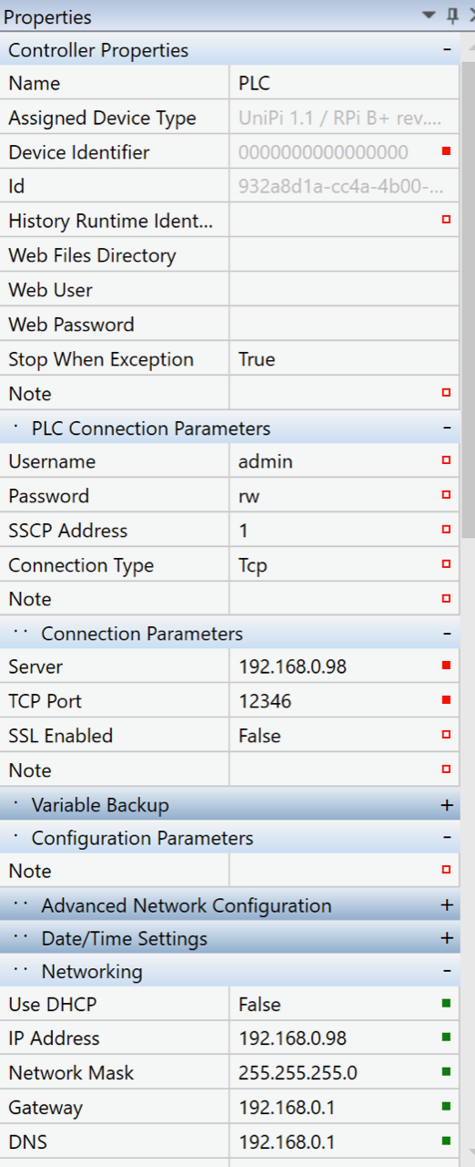

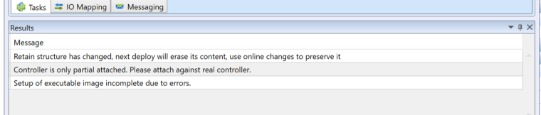

      Hi
      when i attach the unipi 1.1 i bougt last week
      it did noch found a plc via UDB Broadcast
      i tried it manually , without a device identifer because i have no!=, but when i try do deploy a solution then it did not work
      mervis result :is controler is only partly attached

          ufa @tomas_hora last edited by
          @tomas_hora said in Could not find PLC via UDP:
          yes i have done this
          i can connect to unipi via ssh without a problem
          but no chance to connect via plc attach mervis
          • U
            @tomas_hora
            if i coonect manualy i am ask for a divice identifer
            is it important ?

                ufa @Iogo last edited by
                @Iogo
                yes i know but upload failed
                I think unipi board is dead raspberry is woring
                is the there a chance to test it
                http://192.168.0.98:8088/ the evok control bord shows no relays ?
                    @Iogo
                    i bougt a unipi 1 with a rasp 3 from you
                    mervis coult noch attach plc properly
                      tomas_hora administrators @ufa last edited by
                      @ufa If you can ssh to the RPi with Mervis IMG on it, issue 'systemctl status mervisrt' and you will see if it runs OK.
