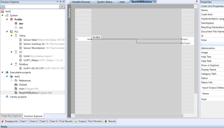

        I found a dirty workaround to create an impulse switch on the HMI Panel. I Made a second FBD that must run after the last program that resets all global variables that are used in the HMI as push button to FALSE. It works, but it's dirty....

              JasperJackson @Feyiama last edited by
              @Feyiama 0_1524994896165_upload-459828a5-1647-4052-8858-1e2bf70c7711
              J 1 Reply Last reply Reply Quote 0
                JasperJackson @JasperJackson last edited by
                @JasperJackson said in HMI Pushbutton:
                Hi! It is really easy, just make a seperate FBD (in this case ResetHMIButtons) which only sets all the global variables used as HMI buttons to FALSE.
                Have fun!
