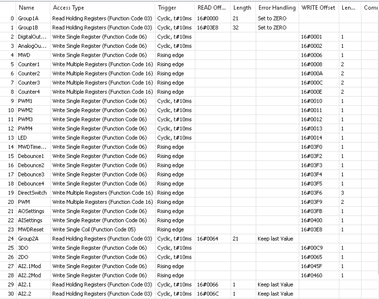

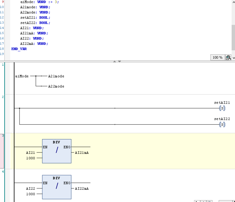

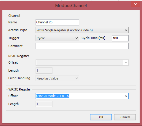

        Hereby some screenshot on how I'm trying to read the AI, feel free to comment!
        0_1525960256242_Modbus Slave Channel.PNG -> Line 27-30
        0_1525960329975_PRG_AI.PNG -> Rank 3/4 (placeholder for conversion from input to what I need)
        So this doesn't seem to work, any suggestions on putting the Unipi AI in the right mode (mA current, setAI21 and setAI22) AND on how to read the values (AI21 and AI22)
        Thank you.

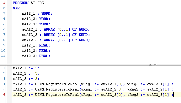

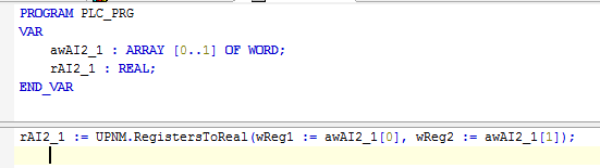

          Analog inputs for example are encoded as IEEE754 values in two registers for each input. The Function RegistersToReal can be used to convert the two register values to REALs.

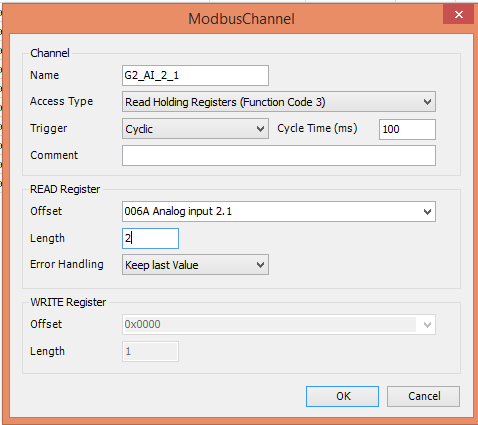

          In a little more detail to read a single AI, map a channel to read two registers
          Map those two registers into a pair of words, I tend to use an array, which can be mapped like this
          or like this
          The code below shows how to convert the registers to a real.

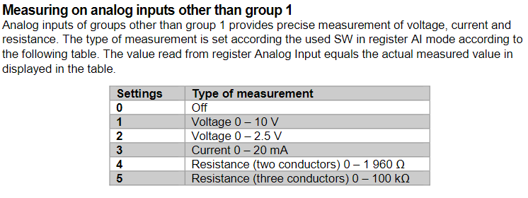

          As far as setting the mode of the input, see the Neuron Technical Documentation, it states
          0_1525979116199_upload-15badc7f-8787-4eab-9a3c-5ebe12881b2b
          To set this value, create a channel like this 0_1525979240724_upload-b844b4af-96bc-40b8-9e0a-7bd217b8c62e and then map a word with the required value (Be careful that codesys doesn't optimise out the word in your application if it is just declared).
          I hope that gets you going - please ask again if you need more assistance.

            Thx!! It works perfectly :)
