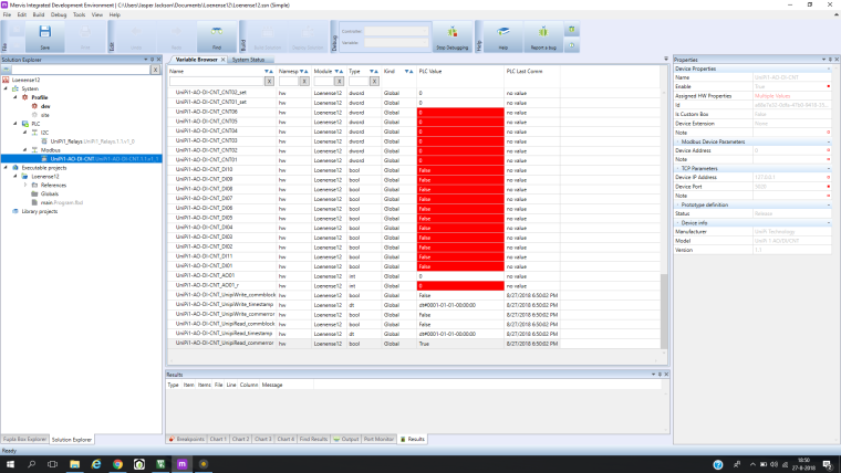

      I have a small problem, the DI don"t seem to work. I have two unipies, one with the latest non-beta (working flawlessly) and one i tried with beta 1.6 and beta 1.7. These don't work for some reason. I Have a Pi 3b+ so I can't use the non-beta.
      Any ideas? Relays are working, CommError on the AO-DI-CNT etc...

            so the error is caused by missing evok-mini package in the image. You can SSH into the PLC and under the root user run the apt install evok-mini command and then reboot the PLC (just to be sure).

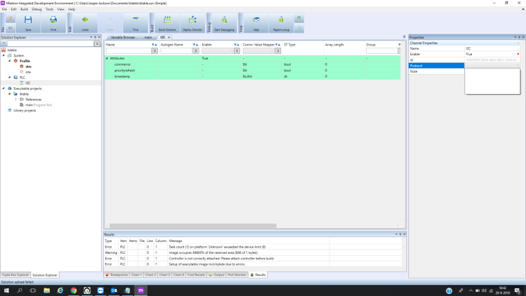

                It looks like there is another issue with the 1.7, when creating the I2C channel no protocols are listed.. I'll try the 1.6 now...

                  this issue is not caused by the MervisOS, but the MervisIDE. As I can see from the screenshot, you use some ultra-beta version which you probably received from one of my colleagues:) I will send you the latest version we have, but be aware, that it is still a beta with minor bugs and still not ready for production.

                    as we discussed via email, the image 1.7 and latest development version of MervisIDE fixes the problem you have encountered. Another problem occured when reading states of the digital inputs. We discovered a problem in the installation package and issued a new version. To fix your problem, SSH into the PLC and issue these commands:
                    sudo su
                    dpkg -P evok-mini pigpio
                    apt-get update
                    apt-get clean
                    apt-get install evok-mini
                    reboot
                    For clean image 1.7 you just need to install the fixed evok-mini package.
