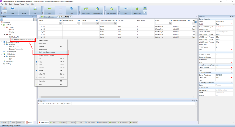

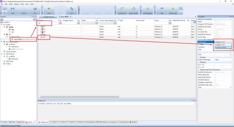

          Can I ask you for just a printscreen or hint, how to set an input to 4-20 mA in new version? Or if you have just a skeleton of AI tutorial....?
          Thank you
          Dalibor
            Martin Kudláček @dalibor last edited by
            Hi @dalibor
            changing the modes is done on the prototype of the device. Double click on the prototype in the Left panel, search for the AI, select the AI for which you want to change the mode and in the Properties panel change the Analog type parameter.
            Then right click on the prototype and select Configure UniPi Module and proceed with subsequent dialogs.
