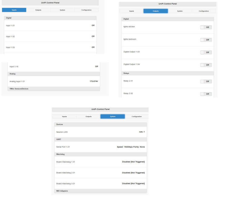

            Do you see the other Axon inputs and outputs in the web interface, and if so, could you take a screenshot of it? The underlying stack for 1-Wire is quite simple - it consists of an OWFS server interface and an I2C 1-Wire adapter (with a device-specific hardware power switch, allowing it to be turned off/restarted independently of the rest of the system). While it is possible that the faulty behavior is due to a software issue, it's not the likeliest possibility in this case.

              All the other outputs and inputs are visible, and activating digital outputs in the web interface triggers them (or their status indication diodes, anyway).
