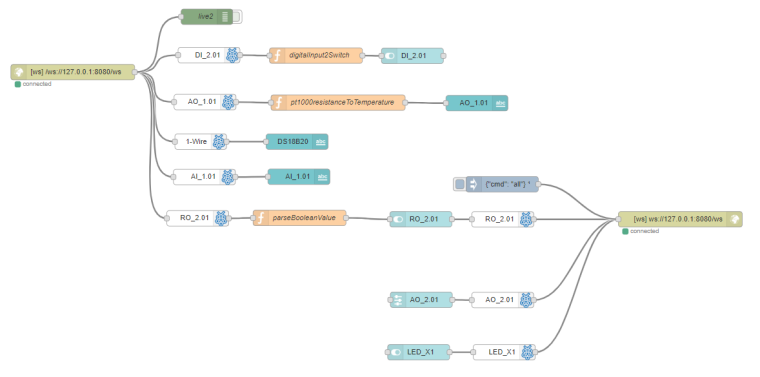

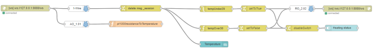

            As for the Evok - we are finishing with Node-RED nodes for UniPi which internally use Evok. Here are some quick mockups of how it will be used:
            Basic usage of all inputs and outputs:
            Some basic regulation of heating with hysteresis:
