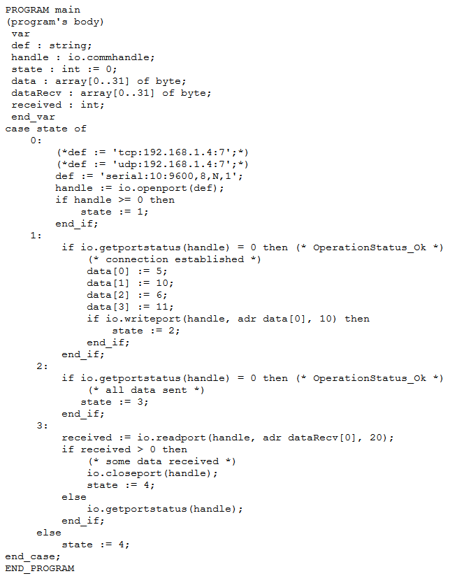

        yes, it is possible, but it requires to write your own parser of data in ST code. This is an excerpt from help files of how it could be done:
        Sorry for the printscreen, but copying from help files loses the end of lines...
