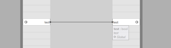

            Hello @robl,
            it is hard to say without looking at the project. The reason could be, that the variable is not used anywhere in the program. The Mervis then ignores the variable and the variable is not available in the HMI (hence the "Unable to write variable link"). You can avoid this behaviour by wiring the variable to itself:
            If that doesn't help, please send the project to support@unipi.technology and I'll take a look at it.
