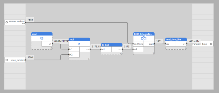

        Martin Kudláček @robl last edited by Martin Kudláček
        Hello @robl,
        that can be achieved for example this way:
        • The "max_random" input specifies the maximum number of seconds, which the random generator will output
        • The "generate_random_time" is controlling input and the random time will be generated upon rising edge
        • The "rand" block generates real number between 0-1.
        • The "mul" block multiplies this number so you can get any number between 0 - "max_random"
        • The "to_lint" converts the real value to lint
        • The "B106 Integer Memory" can store the generated number and pass it to its output upon rising edge of the "generate_random_time" input
        • The "mul_time_lint" has hidden input "in1" set to "t#1s". This time constant is multiplied by the generated number, thus generating random seconds.
        Is this logic doing what you are looking for?
          robl last edited by robl
          Yes! So obvious when you see it! Thanks :)
          Looking at the debug output, the rand block is running all the time, even though it is only needed to generate one number at a time. I am not sure if this wastes CPU, or if it is more efficient to only enable it when triggered, and turn it off again once the number has been generated. What do you think?
          I took your logic and made it behave like TON but with a random time (so, the output of my timer will go in to this, then the output of this will be delayed by some random time, so the result would be, the light will come with a random delay of on up to an hour after 6PM, or whenever the time is set by the timer.)
          (This first turns on the rand -> integer sequence for 1s, then after 1s, TON_0 switches on to capture number and to activate the actual switch on delay)
