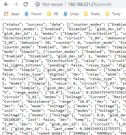

      When I want to get the complete state as JSON
      UniPi answers:
      Using REST ist working:
      Is this a known issue?

          samsoric @Martin Kudláček last edited by
          Hy @martin-kudláček,
          Thanks for the reply!
          Today I tried again to connect with ".../json/all" and it works.
          The only difference compared to my first post is that I restarted the UniPi couple of times whereas at the time of my first post the UniPi was online since weeks.
