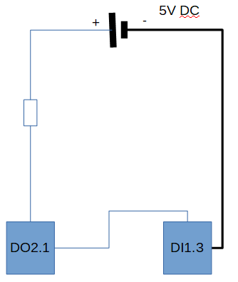

      as I am currently coding my application and I am unsure about electronics. Would the following work for testing purposes? To see the DI changes when DO is set ON? Or is this a really bad idea?
      Thanks a lot!

          Martin Kudláček last edited by
          Hi @knebb,
          definitely not. The DOs are NPN type (open collector). You can read more about how to read the NPN outputs with digital inputs here: https://forum.unipi.technology/topic/712/neuron-12v-digital-input/2
