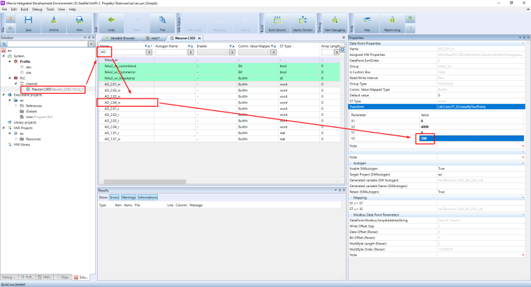

        the easiest way is to use a simple DIV function block, via which you will divide the setpoint variable value by 10 before sending to AO:
        More systematic way, yet more prone to errors, is to use transformation on the write variable:
