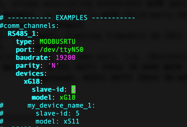

        All evok configuration is yaml, so now I want to configure the xG18, and I want to create the connection, without succes.

        So this is my configuration.
        Now it is not clear to me what I need to configure in the xG18.yaml to read out the 1W-TH-IB2? I would like to read the temperature and humidity. Is there any example available?

          I found that I needed to uncomment another line:
          comm_channels:
          Now the
          xG18 is visible in the system tab.
          After restarting the unipi, the RXTX of the Unipi started to blink (RS485 communication) and the values are visible in the evok-web page.
